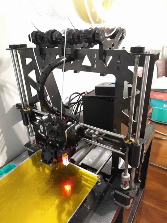

There is this small issue I've been trying to find a solution for quite some time now, and nothing I've tried seems to work. My machine is an FDM printer, i3 style, but I have customized so much of it there is little but a few screws left of the original.
As it looks like it might be a mechanical problem, I'll try to add as much information as I can think of now.
The machine was originally a P3 Steel Pro, but I replaced a bunch of things:
  • Replaced pretty much all the electronics. Got a "premium" RAMPS and Arduino after I killed 1 RAMPS and a couple of Arduinos somehow. Been running with the premium ones for about 4 years now without a hitch. I replaced the drivers that came with the printers with Trinamic drivers, to make the motion silent and smoother.
  • I also replaced the linear bearing rods for the X and Y axis with some custom cut hardened steel linear rods (G6 tolerance) because the ones I previously had were slightly damaged due to a faulty bearing and I thought this might make print quality better.
  • Linear bearings I replaced at the same time I replaced the rods, and got some KH0824PP.

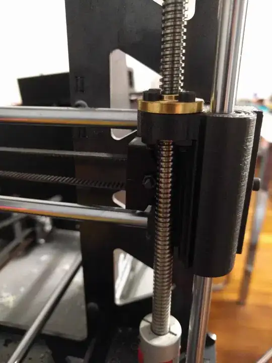

  • Replaced the Z index's lead screws with TR8x2 and plum couplers, expecting this would improve the quality (and it did). At the same time, I installed a custom piece and bearing on top of the Z-axis to make it more rigid (which I have no clue if it worked or not to be honest).
  • Replaced all the GT2 belts with Gates Powergrip belts, also trying to improve the issue here. The idlers got replaced at the same time with Gates idlers.
  • Replaced the belt mechanism for the X-axis (the bed carriage) with one that was easier to tension and was more reliable than the original, which I got from toolson edition. Also replaced the bearing at this time, with an SKF608-2Z.

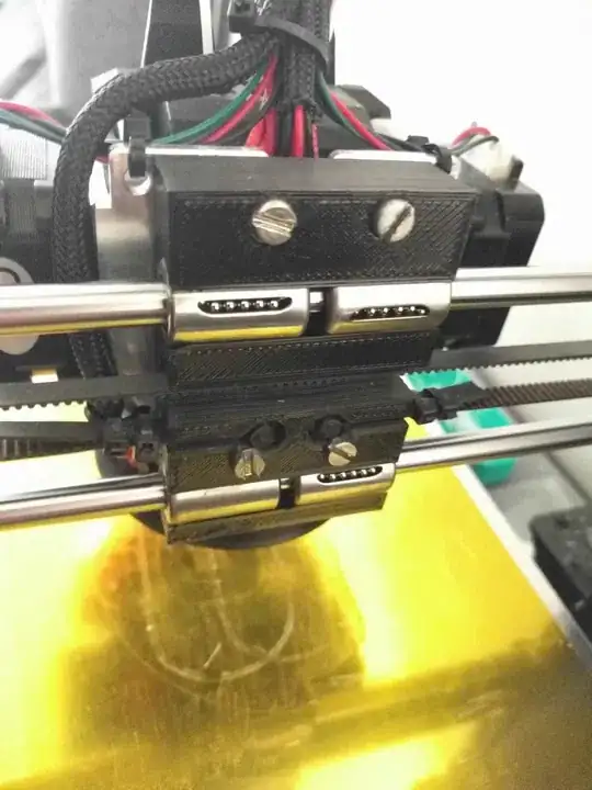

  • Replaced the extruder entirely around January, using a DD BMG-X2 with a e3d chimera+ hotend. The carriage it's mounted on I edited myself from the original carriage, so it would be able to mount this beast.

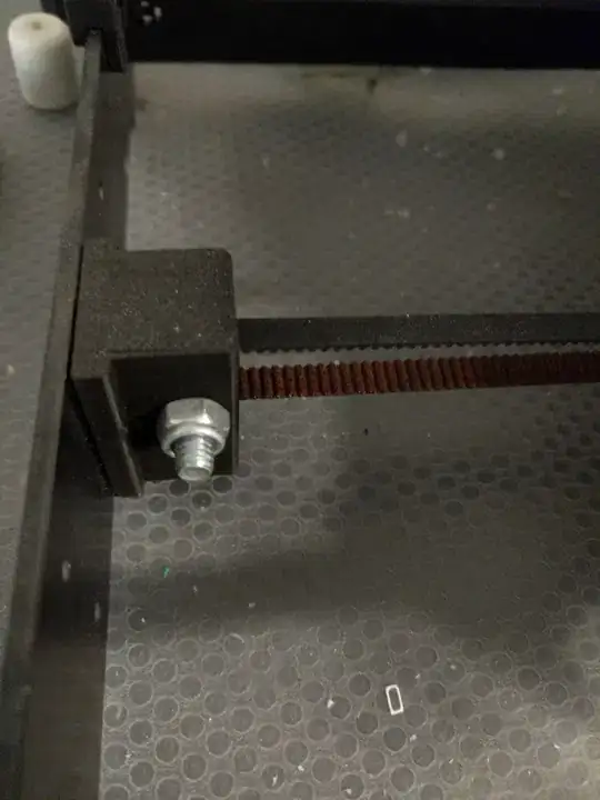

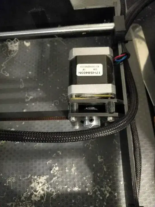

Here is a bunch of pictures (sorry for the dirt, I'm experimenting with some soluble filaments that are being a bit of a mess): printer y axis tensioner y axis iddler x axis iddler and stepper x axis extruder carriage

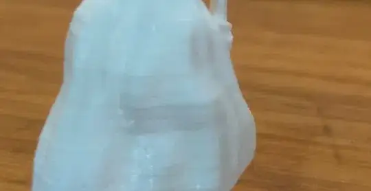

The issue I'm experiencing is that the horizontal lines on some models are very visible/irregular on complex models such as this one:
horizontal lines

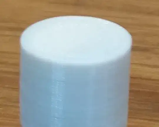

While on models that are more simple like a simple cylinder these lines seem to be barely visible/far more regular:
I see this regardless of line height, though these pictures are at 0.12 mm. I've also seen plenty of pictures of other people's prints that don't seem to suffer from this (like this random google search result).

  • It looks to me like you have a mechanical problem with the rigidity of your axes. What type of mechanisms/linear bearings does your printer have? If it's highly custom can you show some pics? – R.. GitHub STOP HELPING ICE Jul 12 '19 at 20:17
  • I second the comment of @R.., it looks like you have some hysteresis issues when layers are different in shape which you do not encounter when all layers are equal. Please add by [edit] which printer brand you have. – 0scar Jul 13 '19 at 06:28
    Hi, I added as much detail as I could think of and some pictures, if there is anything else I can add that would help, please let me know. – uorbe001 Jul 13 '19 at 11:14
The upgrade described under:

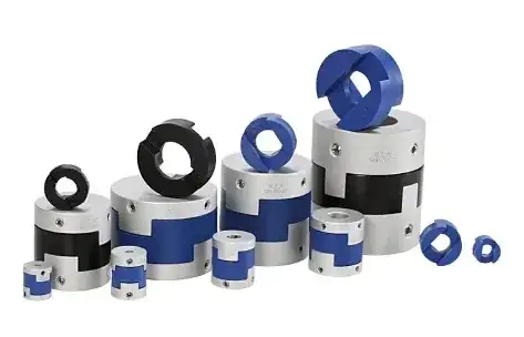

This is not an upgrade. It is best to decouple the movement from the eccentricity of the screw and nut from the X-axis. If you constrain the top, instead of leaving it free, the screw is over constrained, this causes unpredictable movement of the nut and hence defects in your printed object. Decoupling of the screw can be done by Oldham style couplings or specific lifting parts. I've used both to experience increased print quality, the X-Y movement of the nut doesn't get transferred to the hotend carriage.
The couplers can be printed or commercially obtained.
