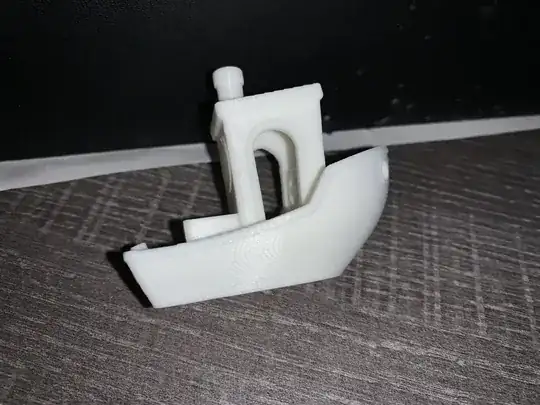

I have an Ender 3 V1 3D printer. When I first got the printer and assembled it, I was able to get very good prints. My post is specifically about horizontal layer lines, and initially with my printer, I didn't see any horizontal layer lines.

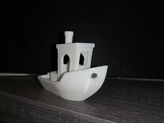

Here are some pics of my last good print:
Good benchy 1
Good benchy 2

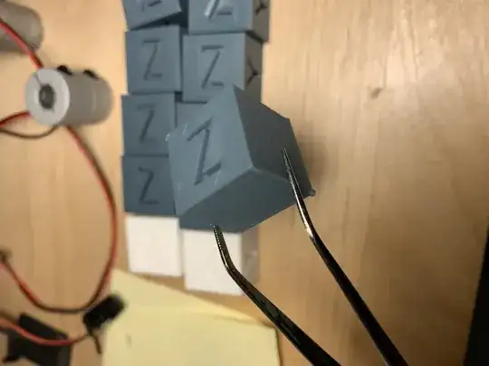

Then, I introduced some changes to my printer. Namely, I got the SKR mini e3 V3.0 and added some other things like a rear electronics box, Octoprint with a Raspberry Pi, an LED light strip, and more. During the time of these upgrades, my printer was down until I completed all of the upgrades, which also included the disassembly of some parts of the printer.

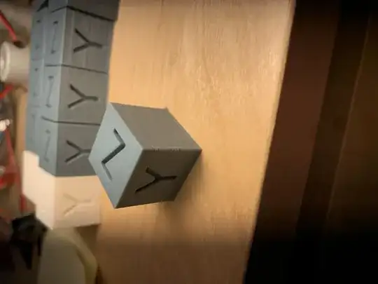

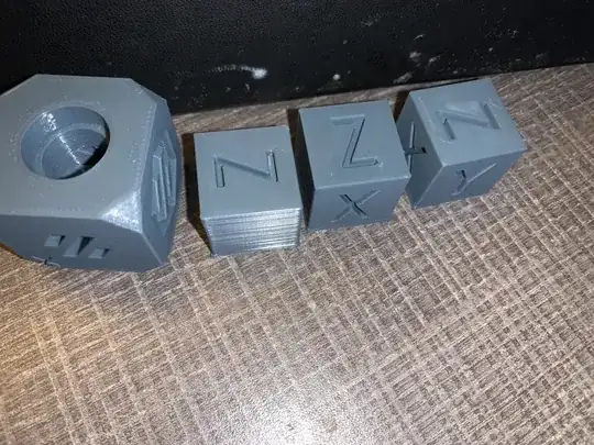

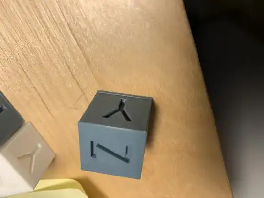

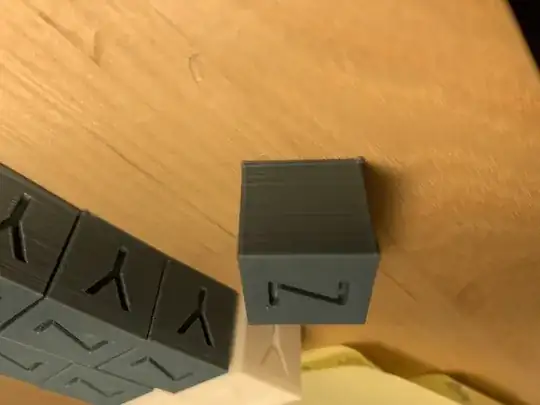

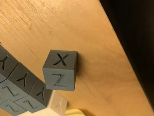

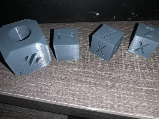

Ever since completing those upgrades, I've had uneven horizontal lines on my prints.
Horizontal Line 1
Horizontal Line 2
Horizontal Line 3
Horizontal Line 4
Horizontal Line 5
Horizontal Line 6
Horizontal Line 7
I've tried so many things, it's unbelievable. I've printed hundreds of calibration cubes and have adjusted many things.

  • It's a silly question, but did you do all of these prints on octoprint or did you try using the SD card too? It's been a few years since I used octoprint, but I do remember there being some funkiness printing off of it, like sending a line of gcode at a time or something (which SHOULDN'T affect print quality) and it's one more potential source of errors. – Lux Claridge Apr 16 '22 at 20:43
    @LuxClaridge It is reported that older Raspberry Pi's and Pi zeros aren't fast enough to produce good prints. So, that is a possibility. – 0scar Apr 16 '22 at 20:55
    Thanks. I did try printing with the SD card only. The print looked identical to the Octoprint one. – geekgeek4 Apr 17 '22 at 02:54
  • Did you introduce a "Flexible Z-rod coupler", and what kind? These are known for creating problems. Furthermore, you have an Ender 3 printer, you can't expect Ultimaker quality prints. I see the banding in the cubes, but to say that it is printing badly... The Ender 3 is a popular cheap printer with design flaws, but, it has some good design features with respect to the previous generation that had acrylic frames. – 0scar Apr 17 '22 at 05:01
  • The coupler I am using is this one : https://tinyurl.com/2p88atez. I bought the coupler in response to the banding. So the issue was there before. The print quality was pretty much identical after adding the flexible coupler, as compared to a solid coupler that came with the printer. To be fair, that was expected, since I aligned my z-rod pretty much perfectly. So I didn't expect the flexible coupler to do any 'flexing'. – geekgeek4 Apr 17 '22 at 05:22
  • That's a fair point. However, I used to get really good, consistent layer lines. Also, I see the cubes and benchies that others share, and they have pretty much perfect layer lines. Like literally perfect. Their benchies and cubes have just unbelievable consistency in the layers. It seems like it's possible and some of those posts claim to be fully stock. So I've been trying to aim for that. – geekgeek4 Apr 17 '22 at 05:23
  • @geekgeek4 Those couplings are springs and do not constrain the Z motion. These are the ones most people would skip using or replace when the printer comes with these, for me they gave me inconsistent printing results also. I'm using [Oldham couplings](https://www.thingiverse.com/thing:2910524) nowadays. See [this answer](https://3dprinting.stackexchange.com/a/19249/) for details. There are other alternatives using e.g. axial or thrust bearings to fixate the Z movement. – 0scar Apr 17 '22 at 06:08
  • If you only changed the X and Y whels, it seems plausible that the Z ones are at fault. Especially if you played with the eccentric nuts and overtightened them at some point, the wheels may be imbalanced/not perfectly round as a result of being left compressed in a particular orientation, and that may in turn cause this sort of wobble. – R.. GitHub STOP HELPING ICE Apr 17 '22 at 16:24
  • Note that on the Ender 3, the lead screw and nut are not terribly relevant (or at least not dominant factors) to Z wobble or other Z axis issues because the main source of tension constraining the motion of the carriages is the wheels against the V slots. – R.. GitHub STOP HELPING ICE Apr 17 '22 at 16:27
  • Also, check for play in the undriven side of the gantry. It's possible that it doesn't reliably follow the driven side, but instead moves upward an inconsistent and unreproducible amount that varies by layer. – R.. GitHub STOP HELPING ICE Apr 17 '22 at 16:30
  • Thanks for the suggestions. I have ordered some wheels. I only replaced the X and Y wheels because that's all of the wheels I had on hand. I also felt some slight hesitance at some points when moving the X and Y. As for the undriven side of the gantry, the dual z upgrade should fix that, but it does seem to move appropriately and is tightened. – geekgeek4 Apr 18 '22 at 05:52
  • I also ordered parts for this upgrade : https://www.thingiverse.com/thing:4857627. I thought it was pretty interesting and seems like it could possibly work well for me. – geekgeek4 Apr 18 '22 at 05:53
