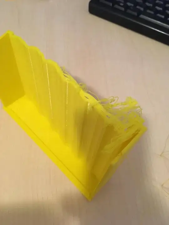

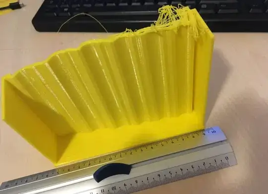

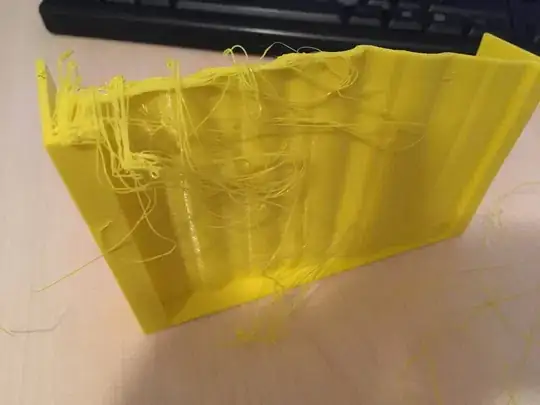

Here are some photos of printed model.
Failed print - photo#1
Failed print - photo#2
Failed print - photo#3
I use Esun PLA+, the part was on baseplate without any loss of contact. It was like one layer missed its coordinates and then all corrupted.
I think it's not related with bed adhesion because for example for this model, it didn't knock over the model.

  • Can you give examples of some models it happens with? You probably have both warping problems (bringing material above the nominal Z) and bed adhesion problems. Up to the point that printed, there should be no travel moves because the layers are simply connected. Is there a roof like the base that's getting started when it fails? If so the problem is likely failed bridging without support - the failed bridge creates string junk that curls randomly (sometimes up) for the print head (not just the nozzle) to catch on and drag. – R.. GitHub STOP HELPING ICE Jun 18 '19 at 04:23
  • What material are you using? Often this "knock over" is due to warping or loss of contact with the baseplate, so that the nozzle isn't hitting the part but the filament itself is dragging the part along with the nozzle. Every photo there sure looks like the part moved, as you can see strings which should have been over the end-edge. As one layer was skipped then that suggests a possible skip in the X or Y-drive. Not to be a buzzkill, but Ender machines do seem to produce more 'failed print' questions here than any other brand. – Carl Witthoft Jun 18 '19 at 14:30
  • WIth a base like that, it should take some serious force to remove the part from the build plate, and I'd even worry about damaging the build surface if I didn't use a blade to separate it. I wonder if you have way too much distance between the nozzle at height 0 and the build surface resulting in poor adhesion. It's possible that you also have an issue like stepper skips/layer shift, as Carl suggested, but it's not clear which came first, the separation of the print from the build surface, or the misaligned attempted layers on top, and either could have caused the other. – R.. GitHub STOP HELPING ICE Jun 18 '19 at 17:54
    Folks voting to close this, **it's not a duplicate**; rather OP's question is misstated. The underlying problem here is not the nozzle hitting the model but something else (either breaking off the build plate, or a layer shift or other problem causing junk material that the print head can hit). – R.. GitHub STOP HELPING ICE Jun 18 '19 at 17:56

There is a clear scar in the print that looks like the print head has hit it. The scar is about 1/3 of the way up the straight return segment on the right side of the photo.
The OP has provided enough information to show that it isn't an overhang or bridging problem.
I don't see any cracks in the print where part of it may have separated and bent upwards. I accept the OP's statement that the item is well attached to the bed.
