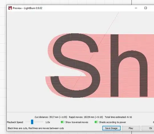

I am using LightBurn to laser engrave on wood. I am just trying to print some letters.
In the softwares preview the output looks correct. The black part is where the laser should burn and the red part are traversal/scan lines enter image description here
When i actually print it the negative space is burnt by the laser (basically where the traversal/scan lines are shown in the preview above)
