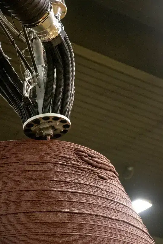

The photo below shows part of the printer. Is this printer just leaving a slurry to dry, or does the mixture somehow catalyze or harden spontaneously? I'm also wondering what the (looks like) twelve black hoses are around the central nozzle.

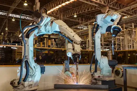

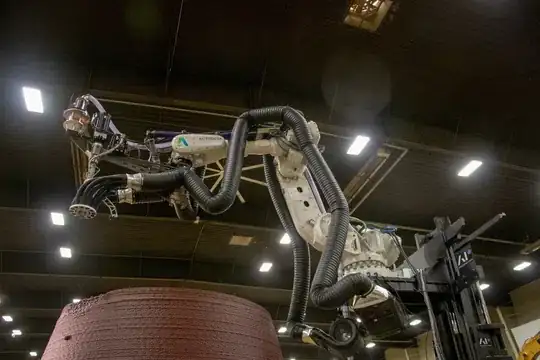

Let's start with the general design look and feel: This printer contains a robotic arm with a toolhead, pretty similar to a welding robot, and probably is controlled with a similar CAM software.
a welding robot Picture by Robotics.org

Black pipes

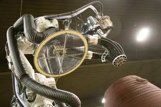

There's a bundle of 12 black pipes that go from the main body to the print head, ending at the side of some distance disk. To me, these look suspiciously like a system to deliver an airstream, so most likely some sort of cooling system. This is further supported by the huge fans at the base of the machine, pumping air into the flexible pipe.
Silver Tank
The first picture shows a silver tank with the label V7 (version 7?) or VT (as in Virginia Tech) or something similar on it. This is connected via a grey hose to the base of the printer. The mounting of it over the extruder hints, that this is a hopper, most likely holding the print material in pelletized or powder form, and that it is fed via the grey hose. From the information given in the question, it might be some sort of PLA (synthesized from cornstarch) or other bioplastic using the Martian dust as a filler material. From here, the print material falls into the central column...
Central Column
...which goes down through the distance disk into the thick nozzle, so it must be the extruder and heater combo. At its top, there is a large stepper motor in Z orientation, which hints that inside of the matte grey tube is an arbor, pressing down the melting pellets past a heating element into the nozzle below.
Print material and further information
The last picture shows proudly "Autodesk" on the side of the printer. Autodesk has an own article about printing in space from August 2018, where Nathan Golino of the NASA owned GMRO states this:

Looking back at the question if that is V7 or VT on the printer's hopper, an article with the same dome printed in OP's question popped up: Virginia Tech had been part of the crews that were taken to the finals of the aforementioned design competition and was part of the finals. They worked with the AI Space Factory team, which came out winning. In a related article, the printer OP showed us can be seen from a different angle and stripped of the cooling pipes and with a different, longer extruder. It tells us a little more about the work distribution of the teams and participants:
Large format vessel printed by AI SpaceFactory in the Autodesk BUILD Space for the construction phase of the competition. The tooling was developed in collaboration with Virginia Tech and Autodesk.
