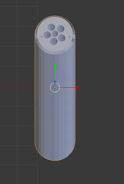

We'd like to print a tube that's 1 mm in diameter, about 1 cm long and has as many micro "tubes" crammed through it as possible, something like this:
Tube containing micro tubes
I currently have a Stratasys j750 in my lab, a UPrint Se and a Prusa i3 Mk3s. They all work well but for the detail I'm looking for, come up a bit short. They have advertised accuracies of 14 microns (well, the j750) but thats just in the z direction, x and y are more like 200. If I went to get PRECISE, what technology should I look into?

That's not gonna cut it. 100 microns is .1mm. +/- 100 microns means it can error that much in either direction from where things should be. To illustrate why this is too much, I'll use the image of the tube in the question, with the 1mm diameter as a scale, and layer the 100micron error potential as a grid over the image:
Margin of error
This grid doesn't show the size of the filament: just margin for error. It's getting close to what we need, but it's not there yet. To reliably create your tubes, you want the error to no more than 1/4 the diameter of a tube itself. Based on the image, the tube size is about 180 microns, so you want to look for something with an error in the range of +/-45 microns. _Maybe you could do this with a tube — more of a rounded rectangle — lying on it's side.
