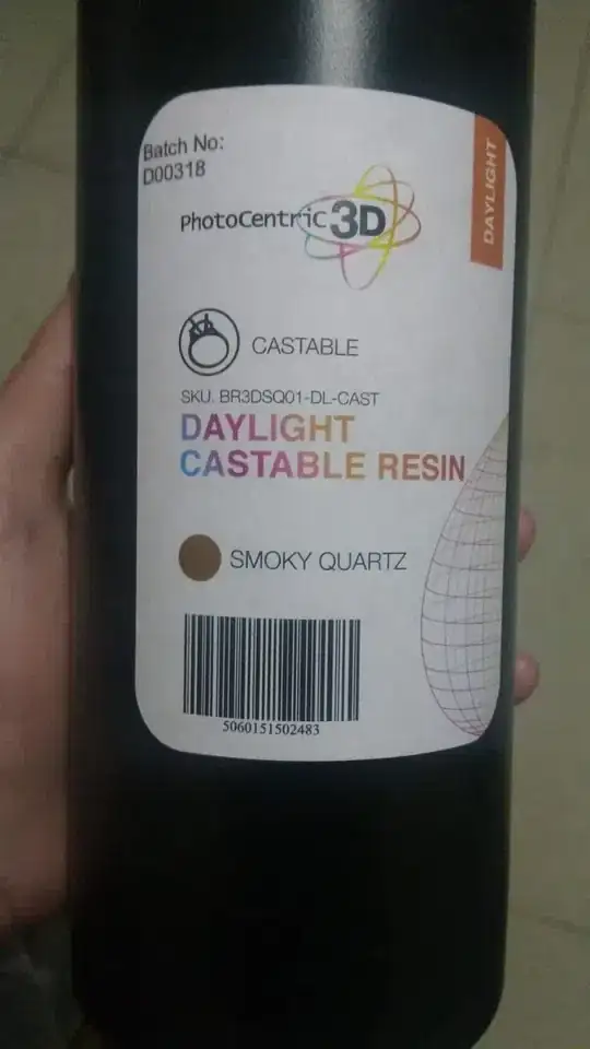

The resin I have is the following:

Factually, the correct process is to heat up the mold hot enough to evaporate the positive.
In investment casting the process to remove the wax or plastic positive is called the "Dewax" and "Burnout preheating".
The answer to your question depends on the material you use to generate a negative mold of the positive product. E.g. many silicate based materials require up to about 1100 °C to fully burnout all residue before pouring in the liquid metal.

If you print a positive from resin and then make a mold from that for lost mold casting, you go the traditional way. But most resins don't melt out the way wax does, and on contact with molten metal don'T evaporate the way wax residue does. You got to properly burn out the remains of the cured resin at a higher temperature and for a longer time than the wax as the melting point is much higher - use a proper burning oven. A proper burning oven in this relation reaches something like an email oven (1100 °C) or a clay burning oven (up to 1800 °C)
Putting the molds with the opening down into one of these ovens at high temperature should help a lot. Make sure to put a spacer and a tray below to allow better airflow and get the resin out.
