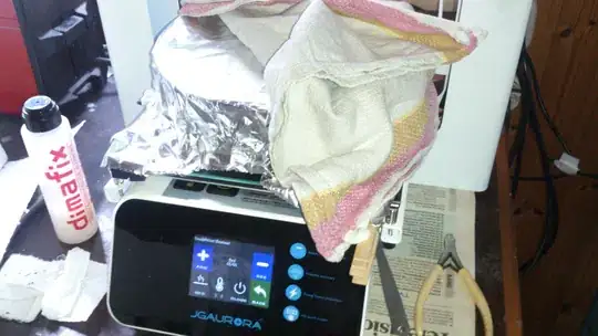

Here is my suggestion for a cheap, well and temperature accurate drying manner of a filament. I've done it several times for PETG that is actually a very moisture absorbing filament and pops it up when using by ruining the job. Why not using your own printer's heat bed to dry the filament (PETG about 6 hours in 65 degrees of Celsius)? I can guarantee that it works: PETGs Drying On a Heatbed
  • Hi Pekka, welcome to 3DP.SE! Although this is a very good proposed method to dry the filament, it actually does not answer the question. Note SE sites are driven by questions and answers, this answer is more something you would post on a forum. Please look into the [help] to learn how SE sites work and please take the [tour]. Thanks! – 0scar Sep 07 '19 at 07:48
  • Ok, sorry :( I hope you destroy my comment cause I don't know how... – Pekka Koivumäki Sep 08 '19 at 14:48
  • @PekkaKoivumäki you didn't do anything wrong. We do allow answers that challenge the premise of the question, i.e. "don't do that, try this instead", as such your answer is perfectly valid, and encouraged. Please don't let the feedback you've had put you off from contributing to the site. – Doctor Jones Apr 12 '21 at 16:06
