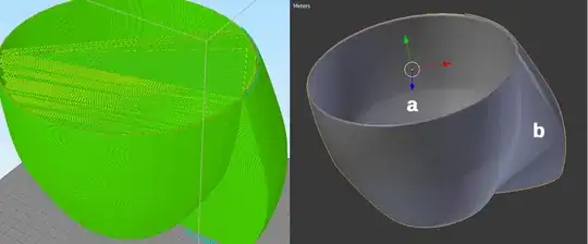

I've added a (G-code) picture to show how the slicer creates strange triangles inside the cup; I really can't understand how to prevent it.
I'm designing the print using the Blender 3D software modelling tool.
on the left theG-code, on the right the Blender model. Note strange additions of triangles inside the "cup"

Check your settings in the slicer software you use: if you look at the sliced print carefully, you see only one line in each layer that crosses the inner section. The lines are also yellow, not green. This strongly hints that these are movement commands, not actual print commands.

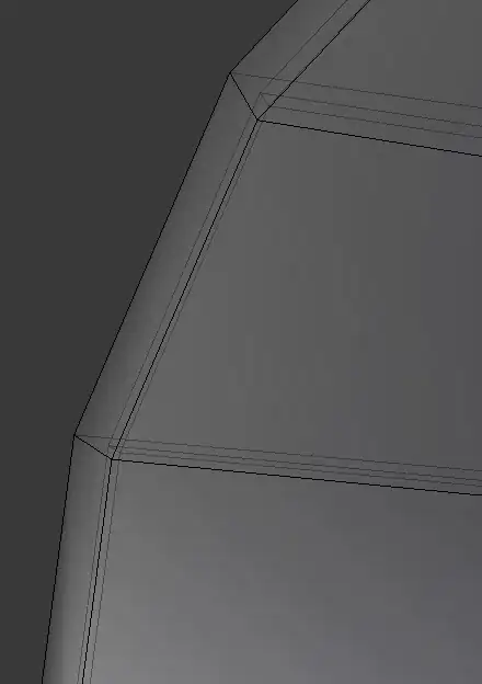

Looking at the model, I also spotted that there was a lingering solidify modifier. Applying that resulted in this:
Shell within shell
This is a particularly bad thing. Fixing is easy though: remove the offending inner vertices.

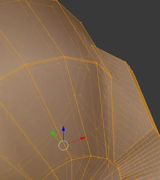

16 verts in one point?!
Atop that, the center points are a clustered mess of vertices - surely you want to merge them into just two vertices.

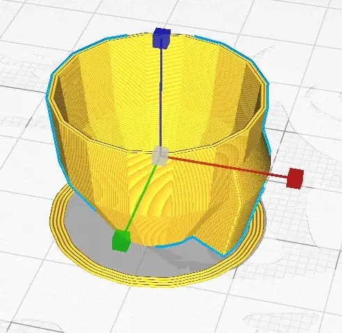

Before exporting, all other items had to be removed (deleted), then the export gives this nice model:
[Cura slice, no scaling

  • tank you for your support. I did double solidify (I had a mesh with 2 lines), so I had the first "bad thing" you notified. excluding this, I had no problem to slice the model. I don't see the clustered meshes (Verts: 1/464). a part that, I'll retry the model to understand if the error was only the double lines-screw. tank you a lot, there was a long time that i tried to understand. – Marco Feb 20 '19 at 15:23
  • @Marco the inner shell was connected to the outer via those vertex clusters, which made the object non-manifold. It was mainly the fix of the non-manifold that eased the problems, but the simplification of the surface does yield better slicing times. – Trish Feb 20 '19 at 15:25
