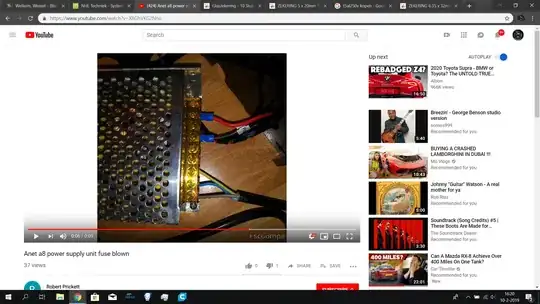

I put all the wires in correctly (as shown in this YouTube video, Anet A8 power supply unit fuse blown, I just searched really quickly, this person has the same problem as me) and "BANG", it blew.
Image from YouTube video

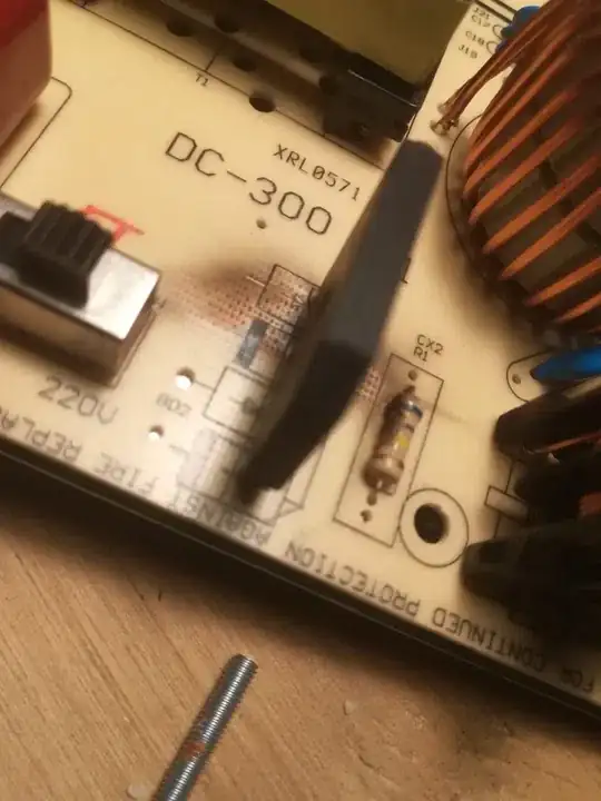

Upon closer inspection I found a burned out resistor in the circuit of the power supply, maybe this caused the bang?

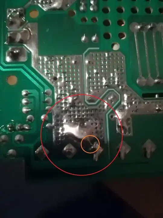

I opened it up and flipped the board, and noticed that there was a big ol' blob of tin connected to one of the pins I connected my wires to. I am very sure that this blob shouldn't connect to that pin at all, hence shorting my board.
Is this the cause?
Close up of PCB
Close up of PCB - Highlighted potential short circuit

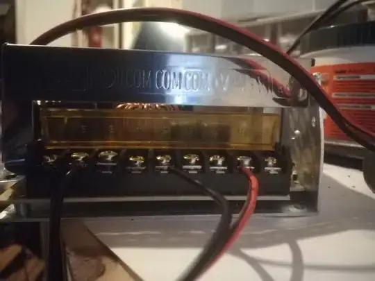

Here is how I wired it up at the PSU side:
Power supply connections

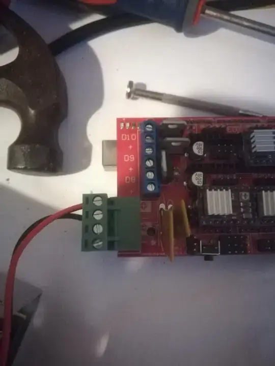

At the RAMPS side:
RAMPS board connections
This shows the internals of the PSU, it clearly shows burn marks:
Overview of the failed electronic component in the PSU

    The resistor shows burn marks, but these are residues from the other component next to it (4-way diode?). I think this question is best asked in the [Electrical Engineering Stack](https://electronics.stackexchange.com/). In reaction to ` Thank god my ramps board is still okay!`; what makes you say that? You have no reason to assume that from this experiment. Is this your second PSU, as the Anet A8 comes with a board and PSU as it is a complete kit, you need to add more information. What kind of PSU did you buy? (make and model or link/image of info plate) – 0scar Feb 11 '19 at 08:49
  • Hello 0scar, thanks for your help so far. I tested it via the cura program, clicking the axis buttons and looking for a flashing light when i did. That did work, so that's why i thought it wasn't toasted yet. But i am no expert so i just hope it still works on 12v – wessel dijkstra Feb 11 '19 at 17:20
  • The lump of solder might just be a result of overheating. If it was the problem for the short, the solder would have vaporized, in your case the rectifier has blown out. I think it is best to ask this at EE.SE. – 0scar Feb 11 '19 at 22:03
You need to closely look at how to connect to the output connectors. In this case it appears that you have wired it correctly according to the stamped in markings above the connectors. You have chosen not to connect the earth, this is strongly advised.

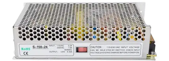

Did you check if the power switch matches the voltage of your country? If you are in Europe the switch should be set to 230 V, not 115 V (which is used in America).
E.g. for the following power supply you see such a switch on the side: PSU voltage setting

  • Hello! I just found this youtube video after i blew it, finding out he used the same method of connecting it as me. The voltage switch is on 230V, which is correct. I looked at charts which told me to connect it this way. – wessel dijkstra Feb 10 '19 at 15:48

My guess is something loose (now vapourised) in the PSU. Electronics have a tendancy of failing either quite soon after manufacture, or lasting reasonably well. This is described with the Bathtub Curve.
Looking at the failure, there was a significant short circuit somewhere - quite likely within the PSU itself. This doesn't mean you can be sure that the RAMPS board survived, but it has a reasonable chance of not being harmed.
There is no significant chance of the PSU failing like that simply due to an excessive load in its output - unless it was overloaded for a significant period of time. Generally these PSUs will have some degree of overload protection even if they are not explicitly designed to survive an overload.

    No, completely wrong (unless your image is misleading, but I doubt it). This is common technique to increase the current carrying capability of the copper track. It goes without saying that you are not experienced enough to safely work on this with the covers removed. – Sean Houlihane Feb 12 '19 at 09:32
