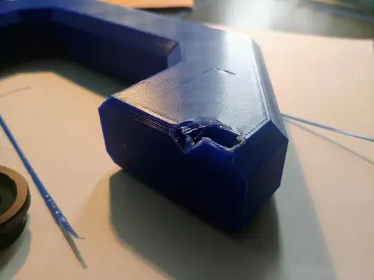

I just completed my first print on my Ender-3 and when the print finalized itself the nozzle didn't elevate itself to clear away from the piece. I watched as the nozzle slowly lowered itself into my print and destroy it. Here is the gcode generated by Slic3r used:

preview of the destruction

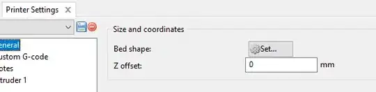

You are using incorrect commands in your end-code for the incorrect tool with respect to the print head raise.
Slic3r has no knowledge of the maximum printer height (as in variable max_print_height) because there is no input field to specify this, as can be seen in this partial screenshot:
Slic3r print area settings

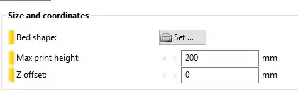

However, in Slic3r PE (Prusa Edition), there is a possibility to enter such a value, as seen in the following partial screenshot:
Slic3r PE print volume settings

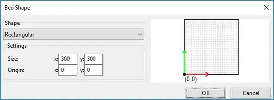

Note that in both editions, the Bed shape interface is equivalent when Set... is pressed: Slic3r and Slic3r PE bed area settings
To use the raising of the head, respecting the maximum print height, in Slic3r PE, you need to add the following line:
{if layer_z < max_print_height}G1 Z{z_offset+min(layer_z+60, max_print_height)}{endif}
This will parse fine in Slic3r PE, but not in Slic3r (as max_print_height is not known).
If you want such a command in Slic3r, you need to enter (for a printer with a maximum print height of 240 mm):
G1 Z{[z_offset]+min([layer_z]+3, 240)}
