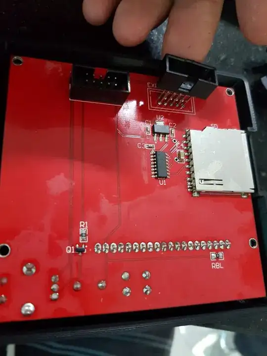

this problem can be solved by turning the slots on the display, as in the image below. Some Chinese displays are inverted from factory.

Yes, my experience was the same, I didn't know you could turn the plastic all the way around, good to know for next time! I just cut some extra slots... – 0scar Jan 30 '19 at 22:11
2I've just switched the slots and it worked like a charm, it made my day! – David Souza Jan 30 '19 at 22:43
