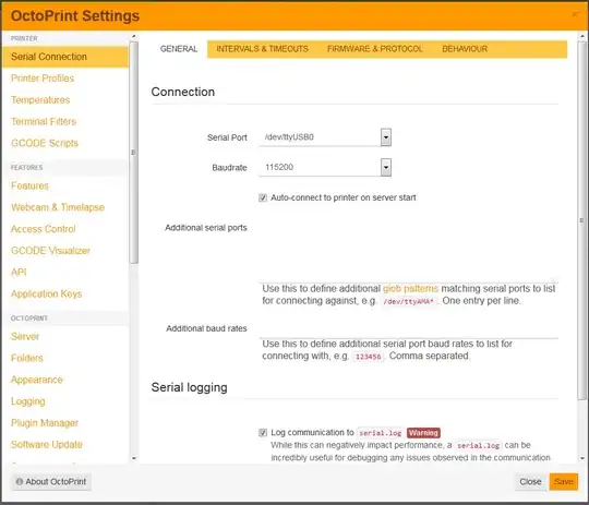

Note that with disabled autoscrolling, you will be able to see more lines up to the point that the buffer is full. If you need even more lines to monitor, just enable the logging the data to file serial.log. If you open the options page (OctoPrint Settings), just tick the box for "Log communication to serial.log" under "Serial logging" of the "Serial connection" options.

Serial logging has to be enabled. Warning: This will impact the performance of OctoPrint. Enabling this feature can be done under Settings -> Serial Connection -> Serial Logging and checking the box for "Log communication to serial.log. OctoPrint Settings
One can download the log under Settings -> Logging and finding serial.log in the list of log files.
