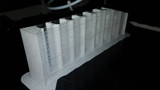

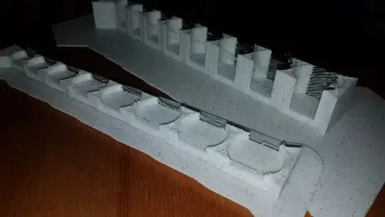

The prints end up like this (unfinished and with a lot of stringing)
fail
This below is actually the best result I got so far.. (important note: there is no under extrusion during the print, it suddenly stops out of nowhere..) fail2 (Although I have to use terrible retraction settings and need a lot of post processing because of all the stringing - you might have an answer for that too.. I just couldnt get the 3d printer to print parts properly with good retraction settings.)
The problem is that at some point of the print, no more (PLA) material is extruded and the printer moves without actually printing anything. The first couple of layers usually work (you can see that in the images) but after wasting almost 600 grams of PLA, I am not able to find a solution myself.

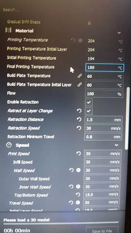

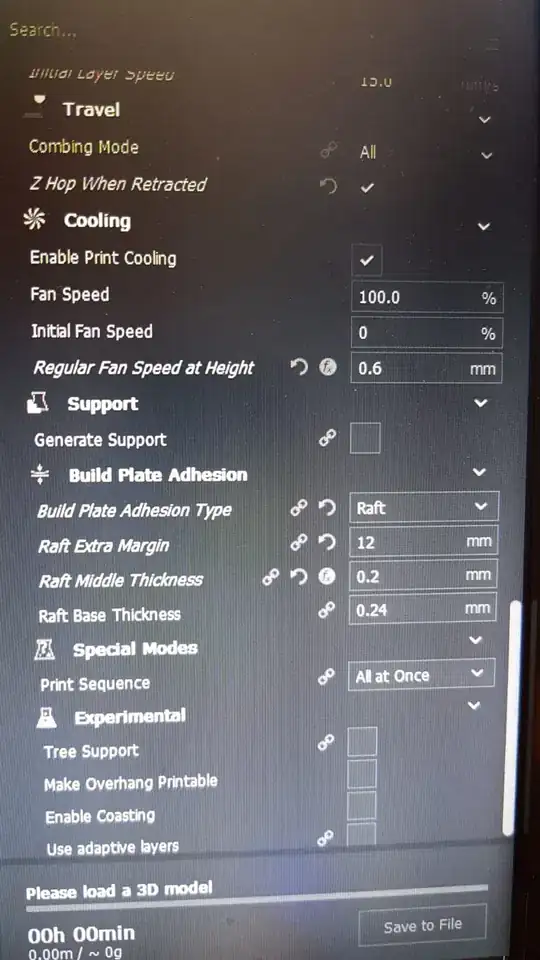

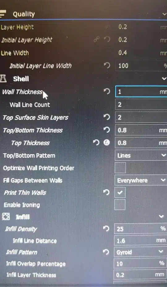

Is it a software problem? Here are all my cura settings (I even reduced the printing speed to 30mm/s at 205°C - still didnt work..) :-(
enter image description here enter image description here enter image description here

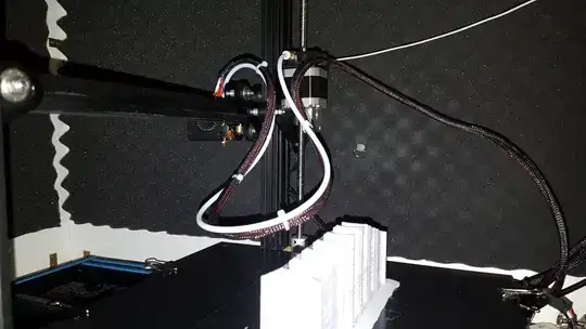

Could the length of the bowden tube and it tangling up be a problem? (as you can see in the image below) enter image description here

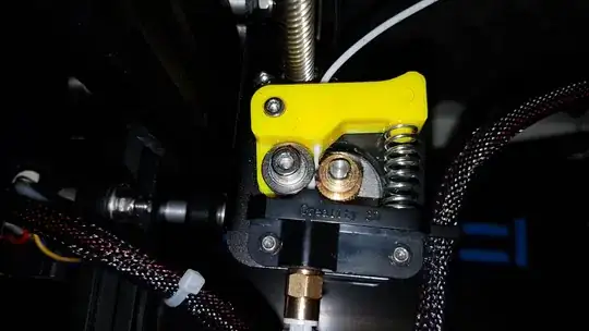

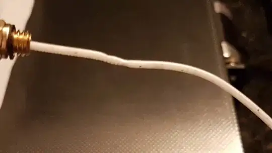

And annother important thing: The feeder always grinds into the filament (even at those low retraction settings) and it is always very hard to pull the filament out of the bowden after a failed print. Sometimes its almost impossible and i have to use heavy tools for it.. that should be the probelem enter image description here

Stringing?
The stringing is explained by your relatively low retraction settings, 1.5 mm is not much for a Bowden setup. As do too high printing temperatures.

What you are experiencing is called clogging, the extruder cannot push the filament through the hotend and cause the grinding you report. Clogging mid printing is usually caused by insufficient cooling (for the temperature you print at) of the cold end (causing heat creep; slowly increasing temperature of the heat break), especially all-metal hotend assemblies are notoriously known for this problem.

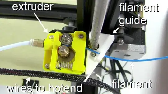

Your Bowden tube does make a lot of kinks, maybe you can improve the path of the Bowden tube. Also if you are concerned about the sharp filament intake angle, you could print a filament guide:
Creality CR-10 extruder assembly with filament guide

    @DonaldEnte - Get known issues fixed first, then move onto the next problem (if there is a "next problem*). I'm betting your main issues are mechanical having to do mainly with the Bowden tube and how it is run ... that's some pretty healthy kinking going on there. – Pᴀᴜʟsᴛᴇʀ2 Jan 16 '19 at 14:45

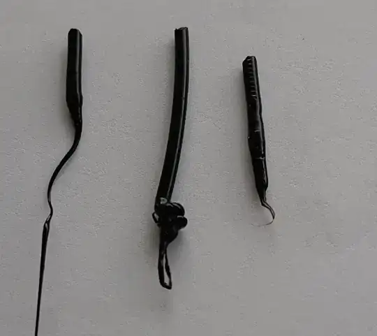

I've had a similar issue once. It was caused by very slight misconfiguration in filament feed rate (my printer tried to push through too much filament). While it was technically overextruding, I didn't realize that until I measured my extrusion lengths. Overextrusion could also contribute to stringing.
When you pull out the filament from your extruder after a print failure, does it have a thicker end? If so, it could be a sign of trying to push too much filament.
On the left is the filament I pulled from the extruder after a normal print - you can see it only gets thinner and has a long end. In the middle is a very pathological case - that shouldn't happen unless something is very wrong. On the right is how the filament was when I had my extruder feed rate misconfigured - you can see the dents from gear biting too hard into it, and a slight bulge. different filament ends
What I think happened in my case, is that filament gets melted in the hotend, some of it gets pushed through the nozzle, the excess wells up into the heatbreak, where it solidifies and bonds to walls, causing blockage and difficulties pulling it out.

A long and bendy bowden tube could cause issues, but I'd expect underextrusion+grinding from that, whereas you don't see any underextrusion. Just to be sure, you could try pushing filament by hand (with other hand holding the lever on your extruder to release the filament) - it shouldn't take much force to move it all the way to extruder, and it shouldn't take much force to push it through the hotend either.
Yet another thing to check is whether your filament gets dented by the extruder gear during normal print. Just insert it until the hotend without holding the lever on extruder and pull it out - it should be as smooth and round as it was before insertion. If it has dents from the extruder gear, that could also be the source of your problems. In that case, you'll need to reduce tension on your extruder spring, or if it's non-adjustable, then get another spring or shorten the existing one.

  • Thank you very much for your help! I will try to fix these issues. Actually, the end of the filament i pull out is thicker than 1.75mm so that might be it! –  Jan 17 '19 at 19:59
  • One more question: i adjusted my extruder gear tension so that it is just right (lower and the filament slips and higher tension and the filament gets extremely dented) but even though i think its good like that, my filament is not perfectly round after pulling it out of the bowden.. Until now i thought, that would be normal. Its not too bad just small knurls of the extruder gear. –  Jan 17 '19 at 20:13
  • @DonaldEnte well, there are tolerances for filament width and smoothness, so if the gear only deforms it a tiny bit, it could be fine. Severely deformed filament could easily get stuck in the hotend though. Compare your knurls to what I have on the right on the photo - what I had probably also caused issues for me. Also could be unusually soft filament. – knah Jan 18 '19 at 00:22
  • @DonaldEnte It is very normal the the end is thicker! Nothing to worry about, the filament is 1.75 mm, the liners 2 mm, that explains the thicker end. – 0scar Jan 18 '19 at 10:26
