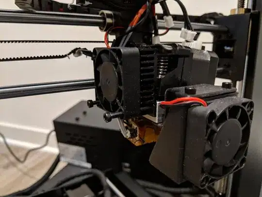

I took apart my extruder component. There's a good video on it here. But basically, you just have to loosen the two bottom screws on the side fan like this: enter image description here

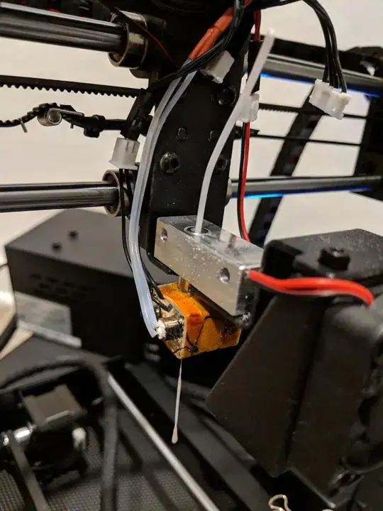

I checked everything out first. I cleaned the extruder head with the included pin. I also shoved the filament through the heated area and filament came out ok. enter image description here

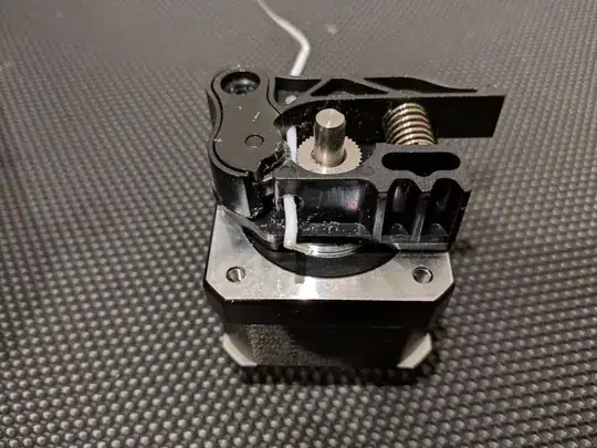

This is the correct way for the filament to go through. It should come out of that plastic hole. enter image description here

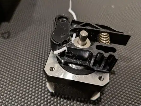

But once in awhile, I accidentally pushed the filament through this way. enter image description here
If the filament was bent and I pushed the lever too hard, it would often find its way down the wrong path. So I played around with how much force I should be holding down the lever and how hard I should be pushing the filament through.
