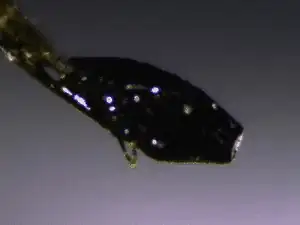

I am a physics graduate student and I want to create some 3D models for my crystal samples. We have an X-ray diffractometer in our lab. It comes with a goniometer inside it, so basically I can take as many photos as needed from any angles. (I have included a gif animation made of 10 photos taken by the machine as an example below)
a gif animation made of ten photos taken by the machine
My problem is, given these 2D photos, am I able to construct 3D models for my crystals in AutoCAD or similar software so that I can determine angles, edge lengths and volume more precisely.

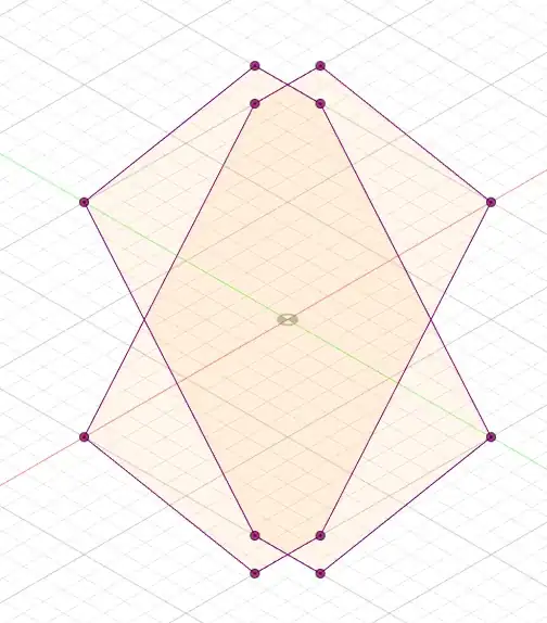

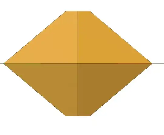

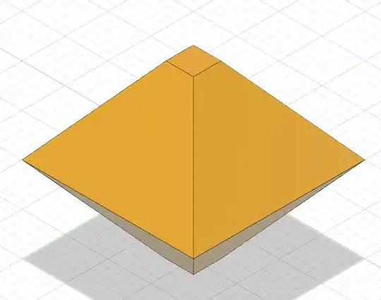

Let's assume I have a perfect crystal like this octahedron with two cut tips Octahedron with upper and lower tip cut

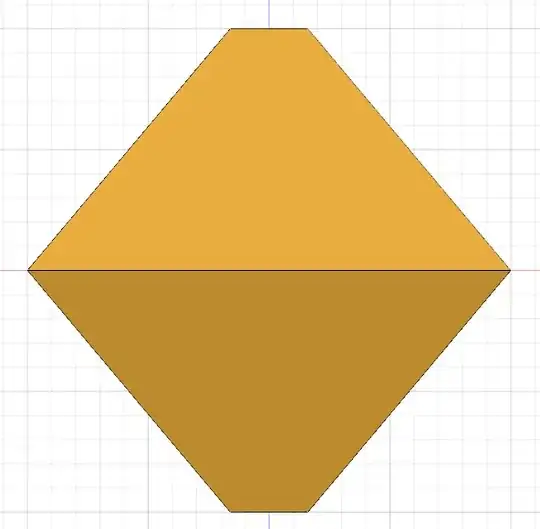

To model this, we need at least a photo of the XZ and YZ shape (that is, 90° rotation to each other), which look like this:
XZ and YZ plane projectionThe outlines traced

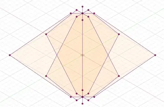

But that shape would also match a double-cone! So we'll need some intermediary photos, in this case, the 45° shot that lies on the plane of (XY-diagonal)Z Plane
Diagonal-Z plane projectionThe traced outlines

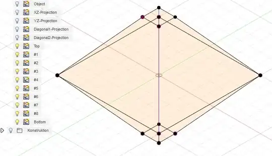

As you see, the more outlines you have, the more detailed the pseudo-body becomes - it is just a gathering of vertices and lines yet though! But, we can take 3 points and create a construction area on these, then draw the face to merge all points on these faces...
construction layers

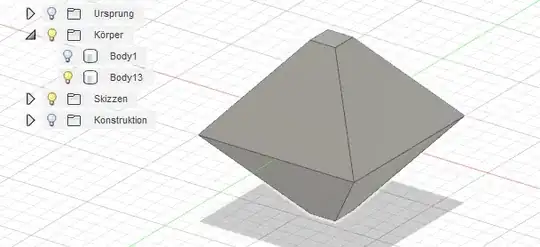

Now, we turn these construction faces into modeling faces, then create a too large object and cut out the whole thing out...
Making the modeling faces Creating the cutout Resulting model
The whole workflow looked like this for 4 pictures (0°, 45°, 90°, 135°)
Workflow
The actual f3D design file is here.

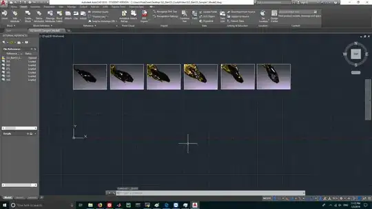

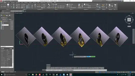

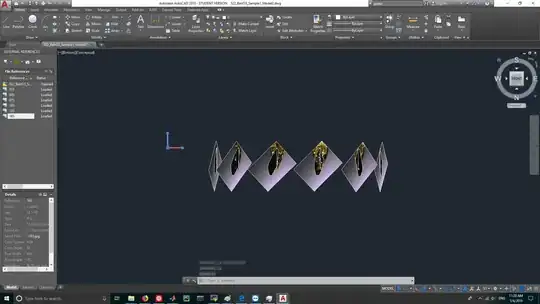

Inspired by the answer given by @Trish and the following YouTube video, I finally worked out the way to reconstruct the 3D crystal model in AutoCAD.

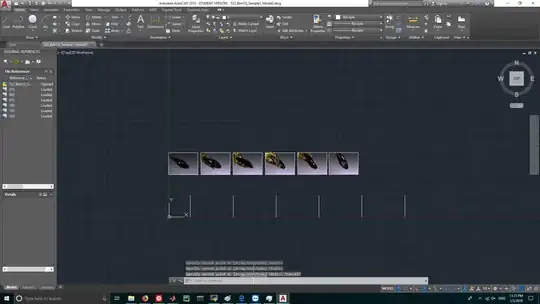

  1. Import 6 images into AutoCAD. The photos are taken from 6 different angles with 30 degrees separation. enter image description here

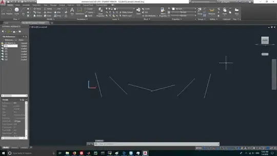

  2. Draw 6 lines of length 100 along Y axis in the XY plane. enter image description here

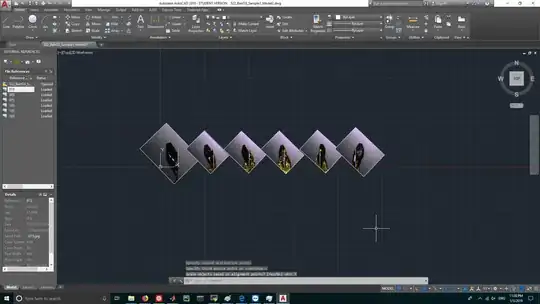

  3. Use ALINE command to align the rotation axis in the photos to the added vertical lines. enter image description here
  4. Use SCALE command to rescale all 6 photos into a uniform size. enter image description here

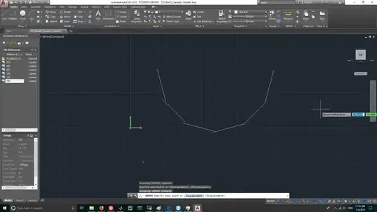

  5. Use POLYLINE command to trace the cross sections from 6 raster images. enter image description here

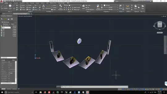

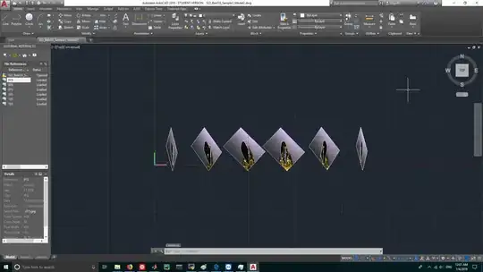

  6. Use 3DROTATE command to rotate 6 images and the corresponding rotation axes and traced cross sections along Y axis. The first picture was rotated 75 degrees clockwise when viewed along the +Y axis, the second 45 degrees, the third 15 degrees, the fourth -15 degrees... (Tips: The rotation gizmo will only show in a 3D view. If you didn't see the gizmo, drag the view cube on the right-top to change the view point and try again.) (view from Y axis) enter image description here (view from Z axis) enter image description here
  7. Use 3DMOVE command to move 6 images so that the rotation axis of each image is aligned in a same circle on the YZ plane. (You would need a little bit calculation to finish this step) (view from Y axis) enter image description here (view from Z axis) enter image description here

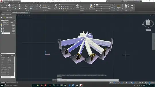

  8. Use EXTRUDE command to extrude 6 cross sections into 6 cylinders, the height of each cylinder should be long enough so that 6 cylinders will intersect. enter image description here
  9. Use INTERSECT command to get the intersected part from 6 cylinders, this would be the wanted crystal model. enter image description here
