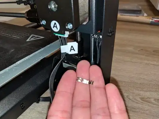

I recently bought my first 3d printer, a monoprice maker select v2.
After a couple of print jobs, this piece fell out.
Printer part
I have no idea where it came from.
But afterwards, I notice that my Z-positioning is all screwed up.
When I select "Home All" to reset all positions to do bed leveling, the extruder tries to push down pass the build-platform, puncturing a hole into the plastic bed cover. There was a lot of clicking from the motor so I immediately turned it off.
I turned it back on and then tried to move the z-position back up. But it moves only about an inch up before the motor starts clicking again.
I was reading some other posts about a "Z-axis limiter switch". Could that be what the little metal fork-like piece is? Where does it go and how do I put it back? And how do I reset my z-position?
Any help appreciated.

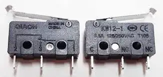

That is the lever that is meant to trigger your Z-Endstop. The variant used in your case is on the cheaper end and is meant to look similar to this QIAOH KN12-1 limit switch:
a KN12-1 Qiaoh micro limit switch
You will either exchange the endstop as a whole, somehow reattach the/a lever or change the physical position of the endstop so that the moving X-axis is triggering it (again).

  • I was able to put the piece back on, but the smooth bar (the thing that holds the extruder) is now uneven. it's higher on one end than the other. any idea how to re-align that bar? – kane Dec 08 '18 at 03:15
  • @kane one way comes to mind: take it apart, repair and re-assemble (it might be bent!). Or - as it has rails - loosen them, realign them, re-tighten – Trish Dec 09 '18 at 04:11
  • I don't know if this was appropriate, but I pushed the z-position as far up as it could go and then it ended up re-aligning my bar. I'll take your advice up next time though – kane Dec 11 '18 at 01:59
  • @kane lucky you! – Trish Dec 11 '18 at 02:02
