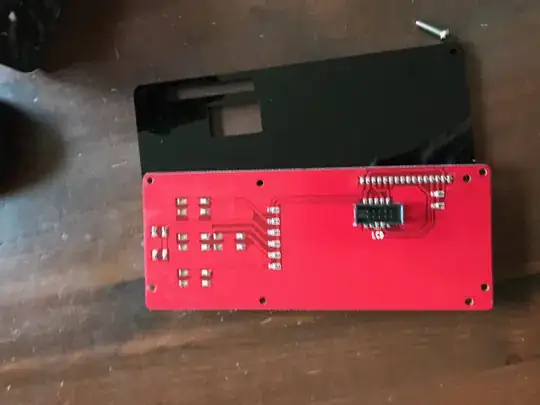

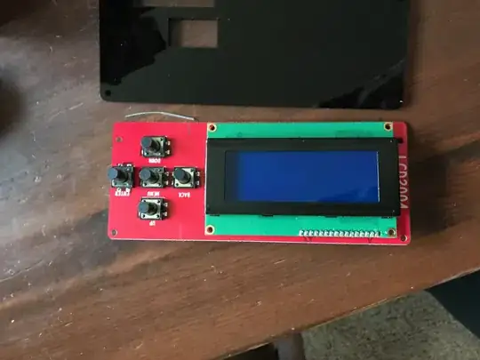

I bought an Anet A6-L printer (after some research I discovered that this is not a genuine Anet A6) and assembled it. The first time I plugged it in, the fan (fan 2, I believe) is the only thing that turns on. Also, the LCD screen (LCD2004 5 button display) only had 1 cord, and 1 jack for the cord to plug in on the back of the screen, but 2 openings on the motherboard. The fan turns on for around 30 seconds, then turns off. I have the anet A6 printer, with the V1-5 motherboard. I have everything else (fans, motors, hotbed, power) plugged into the right ports. I haven't plugged in the micro SD (TF) card yet, I turned it on to test it.

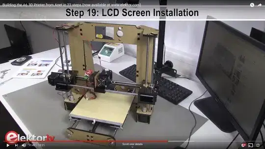

Please do note the the installation of the Anet A6 LCD display (see this movie and the screenshot from this video below) requires 2 flat ribbon cables to function properly.
LCD screen installation Anet A6
2 ribbon cables inserted in printer board

  • Oscar, My screen only came with one flat ribbon cable. It also only has one port for it on the screen, but 2 ports on the motherboard. The image shows a different screen than I have. The screen I have has 5 buttons in a + shape. The one in the image has 2 buttons and a selection disc. My printer is an A6-L printer with auto leveling if that helps. – Tactrophyc Dec 01 '18 at 21:35
  • @JaseKaeberlein Please update your question to include such vital information, even add pictures. It sounds that you have an Anet A6 clone with a 5 button display. To be sure add if you have a 2004 LCD or a full graphical one with the jog dial, I suspect that you have the first. – 0scar Dec 01 '18 at 23:12
  • I'll update my answer tomorrow, thanks for the additions! It appears you do not have a genuine Anet A6. – 0scar Dec 01 '18 at 23:55
  • odd: on Aliexpress, there is a version as "2017 Anet A6-L" that claims to exist in 2 versions with the LCD 2004 screen as 5-button, the LCD 12864 as button dial. LCD 2004 is the cheaper model. – Trish Dec 02 '18 at 10:05
  • I have done some research, and have confirmed that it is not a genuine A6. The instructions and motherboard say A6, as does the amazon recipt and seller. However, the frame is an A8 frame, as is the screen. I belive we are going to return the printer, and get it from a different seller. Thank you for your help. – Tactrophyc Dec 03 '18 at 02:35
