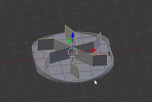

I have designed a bread mark and printed it on the Prusa i3 MK3.
Bread mark

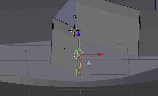

I wanted it to have as sharp edges as possible, so I used a triangle:
Triangle
However, it seems that the print cut off layers that are too thin (x-y-wise) and instead of a 1 cm high bread mark, I only have 0.5 cm.

This is dependent on the slicer and the nozzle diameter. Typically, you cannot print a wall smaller than twice the nozzle diameter because walls need an inner and outer line. Therefore, your slicer will make some cutoff and won't print walls below a certain threshold, in order to try to faithfully replicate your model.
Slic3r, I believe, will automatically go down to single line walls, but if you turn on "Detect thin walls" in Slic3r's Print Settings, more of the thin walls will be printed. Slic3r will actually reduce the plastic extruded to attempt to make even thinner walls, but there's still a limit.
With a 0.4 mm nozzle, you should design walls no smaller than 0.8 mm, or 0.4 mm at the very smallest.
Marcus Adams
  • 143
The absolute minimum a slicer will allow existing in a g-code is one extrusion diameter, which is typically roundabout a nozzle diameter. So for a standard 0.4 mm nozzle, the model will be cut in a way that keeps at least 0.4 mm thick walls, or, if the slicer is extra careful, double that, as the model demands 2 walls next to each other. The result is, that the model with such sharp walls will be cut till the model does conform to the minimum wall thickness - in your case about half the height of the model.
