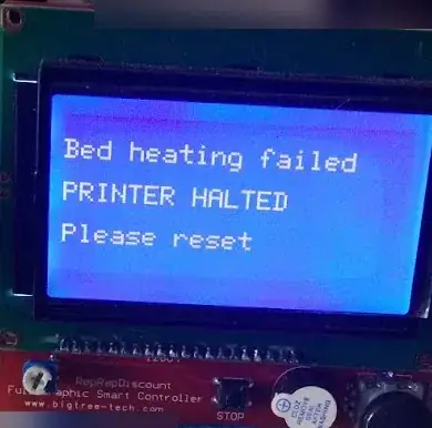

Running my Ultrabase (glass plate) through a MOSFET on an stock A8 board with Marlin 1.1.8. When I do PID tune through Pronterface (by using the M303 E-1 C8 S70 command) the bed heats up no problem and completes the tune, but when printing from SD or using the Preheat PLA command on the printer to heat the bed, nothing happens and then I get "Bed heating failed".

Message take about 1 minute to appear, seems to be a timeout as opposed to an instant error

I'm guessing that you experience this LCD screen:
"Bed heating failed" message
