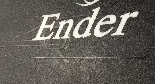

I had a couple of recent nozzle/bed crashes, so I now frequently do a manual bed levelling. I do these while the bed is heated to allow for expansion.
Today I found, after levelling, a subsequent print could vary from having too much clearance (paper moves very freely) to less than no clearance (which left deep grooves in the bed as per the photo).
Photo of bed
What are the possible causes? Is it just a dodgy Z-limit switch or something else? What solutions are available and at what cost? Obviously an ABL seems essential now, but requires a lot of hardware and setup.
It has just happened again so here are some more details.
Printing PLA this time:
  • Preheated bed.
  • Levelled bed all over and got a very good raft.
  • Print failed later so the print was aborted.
  • Restarted the same print job.
  • Nozzle gouged out a uniform depth trench around print perimeter.
The uniform depth of the gouge indicates a problem related to Z-axis only as the bed remains flat and level, but the height is off. That is to say, the bed is flat and level before and after this occurs.
Please note: I have done over 100 successful prints, prior to this issue, so I do have some knowledge about levelling the bed. I am interested in what could cause such a large variation. Initially I thought it was temperature as I switched to ABS at the time, but it now varies from one print to the next.
The machine is a month old and rock solid. The Z-axis is the slowest moving axis, controlled by the limit switch only, hence my suspecting that is the cause.
I purchased a couple of spare Ender 3's and will update various parts in turn to see what the cause is. The metal trigger on my Z-limit switch seems a little floppy sideways, but I am also starting to suspect the bed springs have lost their springiness.
I have the removal bed version and also a borosilicate glass bed. The glass is perfectly flat and the standard removable is dipped ever so slightly in the middle, but the difference is huge when it goes wrong. As you can see from the photo the trench it digs is quite uniform depth. That's why I keep coming back to the Z-limit switch. I have a spare switch now so will try that next.

  • I doubt it's the z-limit switch. I'd think two things: you aren't leveling your bed correctly; you've got some unaccounted for slop in your setup which allows the bed to come out of calibration *after* you've done your calibration. – Pᴀᴜʟsᴛᴇʀ2 Nov 10 '18 at 13:27
  • Did the physical switch move? Can you check if the bed is flat? Distortion could be an issue. Did you test the physical reliability? – Trish Nov 10 '18 at 13:36
  • I do a 9 point check and get almost the same tension on a sheet of paper throughout. I was lucky to get a very flat bed (aside from the gouges now present of course!) – Gone Coding Nov 10 '18 at 20:38
  • @Trish: I will check the bolts on the z-limit, but that would mean it has moved both up and down and up again. Thanks – Gone Coding Nov 10 '18 at 20:39
  • I had similar issues on my XY-100 once - the Z-axis limit switch was indeed not tightened correctly, and would tilt a bit. You may want to try reducing the Z-axis homing speed to prevent it from exerting too much force, or tightening the switch more. – towe Nov 13 '18 at 11:10
  • Check this black plate sticker that is attached to bed. Take it off and look at bottom side. Mine one swelled up in some places. Replaced with piece of mirror. – filimonic Nov 21 '18 at 17:21
  • It happened to me too, the z limit changed from one print when it was working well to the other where it destroyed completely the magnetic bed... I didn't change any parameter between those two prints so I don't understand what happened! – Lembeu May 29 '19 at 05:59
  • bought a used ender 3 2 days ago, same issue. I just tried levelling it 5 times nad every times it went very flat on the Z-stop or raised up again by 2-3 millimeters, randomly different, regardless of where the bar was at prior to levelling. it's either the connections in the z-motor/rod or the z-stop which is supposed ot be failsafe. ill check the motor connection. – LifeInTheTrees Jan 02 '20 at 21:49
  • Would higher humidity allow the circuit to close earlier? Anybody know the voltage going through that? 5v? It shouldn't jump until completely closed, right? Does it make a difference if the sd card is in the machine when you turn it on vs. inserting it later? – user2941410 Oct 14 '21 at 21:07
  • The second paragraph and [this comment](https://3dprinting.stackexchange.com/questions/7388/ender-3-z-limit-now-unreliable-possible-causes-and-solutions/17823#comment11772_7388) contradict themselves. Regardless, did you manage to fix the issue? – Greenonline Oct 15 '21 at 05:41
    @Greenonline Not contradictory as I was referring to the paper measurements varying on the same points after running a bad print. It did turn out to be a faulty z-stop. The switch had way too much movement in the metal strip. Replaced that and all was well again. – Gone Coding Nov 01 '22 at 11:04
    @GoneCoding - I'm glad that you found the issue and fixed it. As this is a quite a popular question, it would be great to have a verified solution. Would you like to post your comment as an answer and accept it (by clicking on the tick icon next to the answer, once you've posted it)? Thanks in advance. – Greenonline Nov 01 '22 at 19:49
