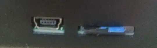

The ender 3 follows the USB standard for a USB-2.0/2.0 revised 5 pin USB-Mini-B.
To prove, a picture of it. Left, you can clearly count the 5 pins that conform to the standard.
Ender-3 front
as a side note: There is no 8 pin USB-Mini - Mini has the T-shape. In fact, there is not even a USB standard conform plug that has 8-pins! The standard allows only 4, 5, 9, 11 and 24 pins

    yes @ifconfig but there is no 8-pin USB Mini that fits into that socket. – Trish Oct 07 '18 at 20:31
  • @Trish thanks! You answered several of my questions in one go! And thanks for taking the time to add the picture. It both helped and added to my knowledge! Kudos! – m.m Oct 07 '18 at 23:09
