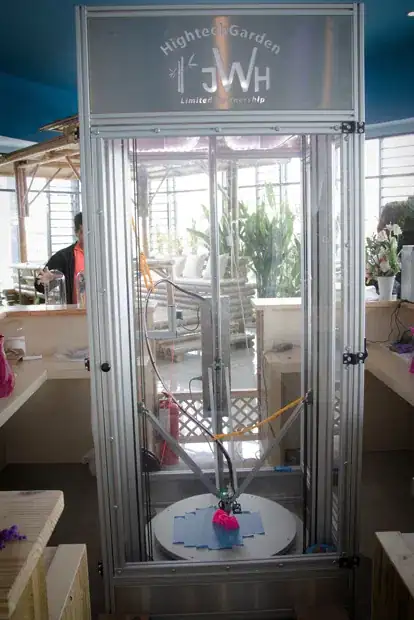

Anecdotally, I visited a 3D Printing shop in Bangkok, JWH High tech Garden, that had a huge Delta printer that had, reputably, cost a million baht (~£20000) if my memory serves me correctly, and was capable of producing prints up to 1000 mm x 600 mm (39.37" x 23.62"):
Large Delta printer
However, the print service was not cheap at all. In May 2017, I was quoted 68000-100000 baht (~£1360-2000) for some printed parts (the proteins) for a Wilson II 3D printer, which are about only £70 on eBay!
Wilson II proteins
However, it is worth taking into consideration that, at the moment, Thailand is very expensive for 3D printing in general, as it is relatively new there, and so prices for both printers and print services are high.
