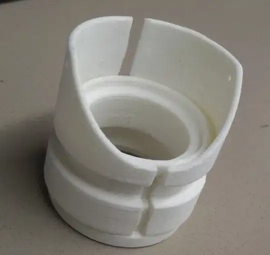

In a design that I need to prototype, I have a coaxial, rotational joint between 2 cylinders connected to another coaxial rotational joint between 2 cylinders by a hinge. I have attached the individual part files as well as their assembly where you can use your mouse cursor to check how they move. Click here for the SolidWorks parts and assembly files
Initially when I 3d printed them by splitting them in half, the outer tube did not close, even after filing the inner tube sufficiently. enter image description here
Could you tell me an alternative method to get this complicated joint working? I need to 3D print them. I plan to use ABS for the 3D printing.
Thanks for your patience :)
EDIT: Lubrication: I plan to use grease to lubricate the sliding surfaces.
Clearances: I printed them without clearances initially (this is my first ever 3D print and I wanted to know how accurate it would be). I then used Dremel and filing tools to file away about 0.5 mm of both the surfaces. It should have been enough for mating the parts. The gap between the edges of the outer shell while trying to close it around is 3-4 mm which doesn't suggest 3D printing inaccuracy. I suspect that the outer tube isn't circular enough in cross section. It meets the inner tube at the the two ends of the semicircle and not inside its belly (you can see it in the picture). I have already tried the obvious, which is removing material from the surfaces wherever the parts touch. The model seems to be too warped for any success. The parts were printed upwards from the bottom, so it is not the warping due to gravity.

  • Is your issue that the two halves of the outer part are not mating up? What kind of tolerances do you have in the model? It's normal for FDM parts to be oversized by ~0.1mm in X and Y. – Ryan Carlyle Mar 08 '16 at 04:19
  • Simple question, but I sometimes forget when I'm designing. Did you account for mating tolerances? As Ryan suggested, you may consider creating a "machining model" that accounts for the capabilities of the process. In the case of FDM, shrinking the part by about 0.007" might help as well as generally giving yourself about 0.005" between surfaces. I wouldn't expect much accuracy beyond that though – tbm0115 Mar 08 '16 at 06:26
  • I have added some more details in the question (under 'EDIT'). Sorry if I wasn't clear. – Shivanand Mar 08 '16 at 14:08

because FDM printing by nature causes "oozing" especially in the x/y directions, I would not be surprised to learn that your outer piece has a smaller inside diameter than your design has specified. You may have to make adjustments to the design to compensate. Those adjustments would be specific to a particular printer/filament combination as well. Calibration prints would make the task slightly easier.
  • SLS could work. I need to check if I have facilities nearby which can do it. It was not a problem of oozing, since I have removed about 0.5mm on both mating surfaces. I suspect the outer shell isn't circular. You can see in the picture that the outer tube meets the inner tube at the the two ends of the semicircle and not inside its belly – Shivanand Mar 08 '16 at 16:34
  • I can now see that the ends of each "arc" are contacting, while the centers of the arcs appear to have air gaps. If force is applied, do the ends join and do the centers contact the inner cylinder? If so, I'd suspect that the outer parts are distorted from a proper cylinder. I've done cross-section prints of a 3d model in order to determine tolerances and clearance without printing the entire project to find something went wrong. If you can slice the bottom of all three pieces and print them, you may find that you have distorted semi-cylinders that have to be compensated/adjusted. – fred_dot_u Mar 08 '16 at 22:29

Depending on your tolerances and how many you need - and how valuable your time is - you can 3D print in ABS with a regular FDM printer, then clear out support material and do an Acetone vapor treatment or vapor wash. It will be smooth enough for most prototypes.
