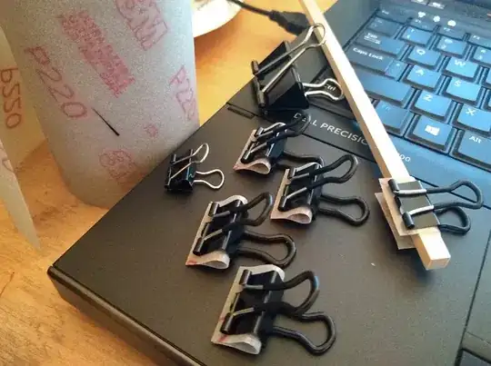

These clamps are very cheap and can be found on those typical auction or Chinese sites.
Alternatively, you can also tape the glass to the aluminium bed using kapton tape if you are concerned about hitting the binder clips.
Note that e.g. in Marlin firmware, you can define a Z-offset to prevent hitting the binder clips on movement.

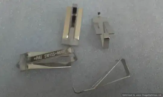

There are some clips similar to Trish's answer that aren't mounted but have a spring in them to apply pressure. Looks like they are called Swiss clips: Glass retaining clips – Swiss made:
Swiss clips

There is the "Swiss Made Glass Retaining Clip" Perplexed Dipole mentioned. Good idea, and instead of having to cut a notch into the aluminium bed, a simple, small hole would be sufficient. About the same price than a frameless picture frame but less construction work!

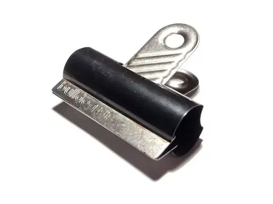

They might not work for every printer, but how about old fashioned bulldog clips:
Bulldog clips
Attached at both end in the y-axis, they will avoid your Z-axis rods and frame (attached in the direction of the x-axis I have noticed them catch against the Z-axis frame).
Like so (except the image below uses the foldback clips that (I assume that) you refer to):
The lever/handles aren't as long as those on foldback clips, and more sturdy too. Also, they have no curled edge that can catch the nozzle if mounted right.
You should obviously route any wiring/tubes away from the clips travel at the rear of the printer.
