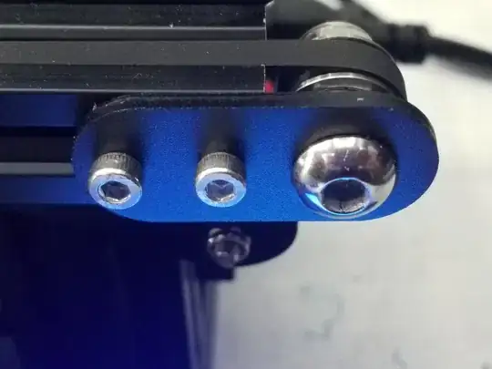

  • Would tightening the belt in some way help e.g. on the motor or the point pictured here. https://imgur.com/gallery/6nvme2n – jb7852 Sep 11 '18 at 13:06

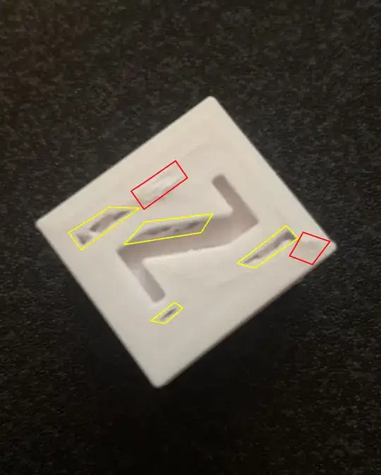

Your top layer looks like you need to add additional top layers and there are signs of a slight bit of over-extrusion in that top layer (red). On the other hand, it looks like the top layer is not sliced nicely resulting in gaps and holes (yellow), which might be a fault of the test print.
Z, defects marked
The X on the file you used is not centered, resulting in the off look in the print.
I suggest you try a different calibration print before starting to tinker with the hardware, for example this.
I suggest to use concentric only for the top layers and instead rely on a simple Zig-Zag pattern for the intermediate layers, as this usually generates a better connection to straight walls.

After examining the machine with jb in chat, the bearing on the X-belt seemed to stick a tiny bit on one side.
Ender3 X-tightener/bearing
Turning the large bolt of the assembly in an attempt to disassemble it without a wrench to hold the self-securing nut on the far side seemed enough to lessen the pressure on the core of the bearing, allowing it to spin freely. In addition, the belt was a little loose.
