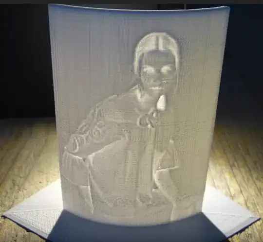

santa on a mug
Another resource that is strictly OpenSCAD is from Eric Buijs, a rather talented 3D design person. His YouTube channel has a number of useful tutorials for both OpenSCAD and Solvespace. This video in particular describes applying a flat object to a curved one using OpenSCAD, resulting in a lithophane.
curved lithophane
As I created this answer, I did not re-watch the 12+ minute video, but I recall how he explains clearly how the program dissects the surface into a number of flat panels and then superimposes the image on each segment. From this presentation, I suspect one could expand to a full cylinder.
