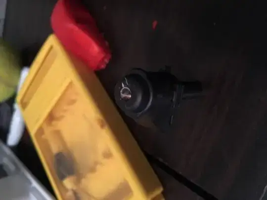

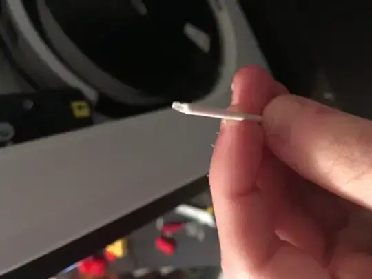

I have an Adventurer 3 printer from Flashforge and every time I unclog it, it gets clogged up again. I’ve done about 6 or 7 prints with it. So after I unclog it, I load the filament and it comes out of the nozzle like it should but once I start a 3D print, it’s clogged again. The process of what I do to unclog it is by heating the nozzle up and then shove a small metal rod down the nozzle to push out the clogged filament. I do this several times until its all gone. I’ve read up on what I can do to prevent it but it doesn’t seem to work. What should I do? enter image description hereenter image description here

I can see from the photo that filament melted and frozen thicker inside extruder. This is the problem and not the clogged extruder. This thick part produce a lot of friction and actually diameter grow until the print finally will stuck. Basically I had the same problem and I could guess that you are also using Bowden setup. The length of this built thicker part is actually corresponded to your retraction length setting in your slicer (the default value in Cura is unreasonably big like 6.5 millimetres). I solved the same problem by decreasing retraction settings to about 2-3 mm. Just try it and I am sure you will not have this problem again.
