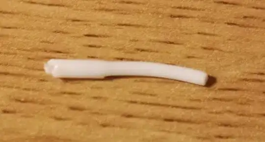

I just tried to remove the filament from the printer (another failed print) I had to use two tongs because the filament was so hard to pull back. I noticed that the diameter of the PLA close to the hotend was a lot bigger (way over 1.75 mm) For about 5 cm that's a very long distance - that's the reason why it's hard to pull back (and also push through?) But I don't know why that happens... If I get an answer for that, I think that I have solved my problem

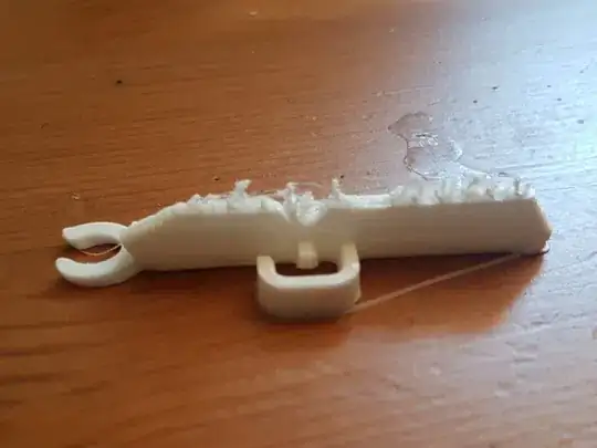

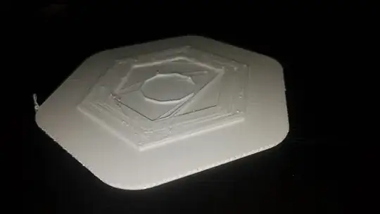

And here some pictures of the failed prints:
Failed print

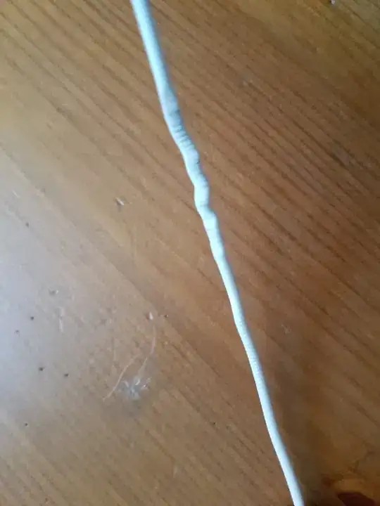

Filament grinding

Failed print #2

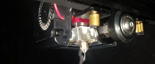

The filament seems to run out of the hotend. Something is really broken here. I tried to lower the print temperature and don't have an issue (at least not that big) with pulling out the filament but instead, the feeder started grinding into the filament again.
Filament exiting nozzle

  • Thank you for the answer. I think it is one of the things you mentioned. The prints started to fail since I bought a new PLA filament. Its diameter is perfectly consistent 1.75mm but its quite soft.. I bought a new Hotend and after installing it, the problem can only be the filament or feeder if its not working right? –  Sep 08 '18 at 10:58
  • If plastic is now spilling out of the hot end then sadly you did what most newcommers do: You inserted the nozzle flush with the heat block, so you have no idea if there is a gap between the throat. This allows the plastic to ooze out between the threads of the throat and block. Don't thread the nozzle all the way down, flush to the heat block. I thread mine until the last thread just disappears. I usually use a piece of 0.5 mm metal to ensure that a gap remains. Then screw the throat in all way until it stops. Lastly, tighten the nozzle. – user77232 Sep 09 '18 at 02:25
