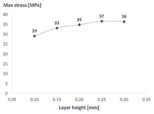

My3dmatter.com performed a series of tests with PLA, using "a universal testing machine". They conclude:
Layer height influences the strength of a printed part when it becomes thin. A printed part at 0.1mm shows a max stress of only 29MPa, as opposed to 35MPa for 0.2mm (21% increase).
Past 0.2mm, the max stress remains fairly constant around 36 MPa (we confirmed this conclusion with an extra test at 0.4mm, not shown here because it was not part of the same batch).
Note: It is recommended to read the full article to comprehend the complexity of the subject matter.

  • @SeanHoulihane Well, the values shows the strength of the whole part taking in count the infill and only one temperature and one speed. The bonding is the strenght adhesion of each layer so this need to be measured like a peel off test.To get the better bonding parameter is necesary to do a Desing of Experiments (DOE) but this expample gives at least the best choice at one temperarure and one speed. Could be opossite with diferents parameters. One day I will do the DOE just to assure the best quality on my prints. – Fernando Baltazar Sep 14 '18 at 19:47

The question is not easy to answer as it would be difficult to give exact print guidelines. This answer from user @typo already shows results of the print height versus the specimen strength (IMHO his answer should be the accepted answer), as taken from this excellent reference at 3DMatter which basically describes the results of a series of experiments. This answer builds upon his answer. In reference to your question, this reference did not optimize the print settings (all specimens are made with the same print settings), so your question is valid.

The print fan cooling parameter could play a very important role here (or even the filament print temperature). In fact, the results of this are already shown by the 3DMatter experiment referenced above. If you keep all print parameters the same except for layer height, the bond strength increases. This implies that in order to get a better bond for low print heights, you should decrease the amount of print-fan cooling flow, or increase the filament print temperature. How much this is should be done in a similar experiment where you lower the cooling air and increase filament print temperature for more specimens (separately) and test again. This is referred to as a design of experiments.
Theoretically, you can make the bond at any layer height just as good provided you optimize the correct parameters. This implies that there is no relation between the print height and the bond strength, it is just a matter of proper setup.

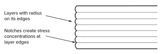

Also, I would not say that poor bonding strength is the cause of failure in Z direction, as FDM deposits layers in between each layer you will have a lot of potential crack initiation locations, this is usually the starting point of the failure. I have seen prints start the failure between the layers, but not continue to crack along the layers, but traversing through the layers meaning that the bonding strength is not that bad after all.
Stress concentrations by FDM process
