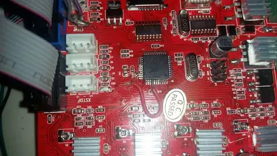

  • It is not attached to the original pin. It is attached to a new pin that I moved it to. I cut the old pin off from the thermistor port and soldered the new pin to the traces of the port. Then I changed the pin in the configuration file, and it works, for a while.

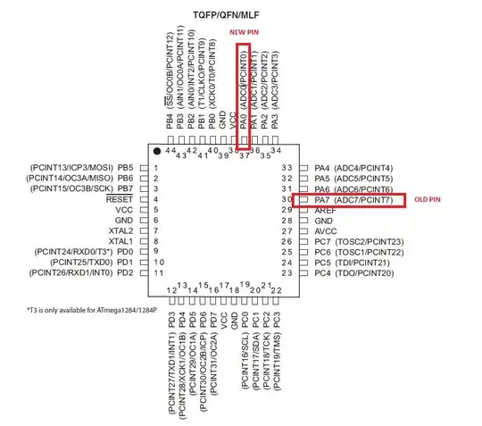

I wanted to come up with a repair solution rather than replacing the board (even though I have plans to do that anyway), so I downloaded the datasheet for the Arduino Mega 1248P and looked for other ADC pins I could use. I found that ADC Pin0 was unused on the board, so I thought I'd isolate old pin (ADC Pin 7), solder the trace to the new pin, and change the firmware to reflect the new pin.
Datasheet pinout
Photo of trace and isolation

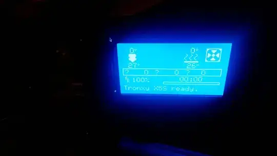

Anyway, my hardware was good, and my software was supposedly good, so I flashed the new firmware, plugged it in, and turned it on:
Good temperature reading

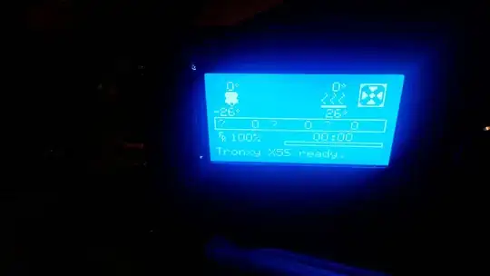

Yay! But after a few seconds...
Bad temperature reading
Boo. It stops working.
