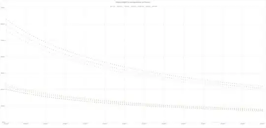

To show this better, a graph: This is the length of a filament spool in dependancy of the density. The values were calculated for the usual diameters with their closest neighbors rounded to 0.1 as absolute diameters and run over a broad range of densities commonly used in plastics - 0.7 g/cm³ to 2 g/cm³.
length of filament depending on diameter and density

  • @nebogipfel also, added a (huge) graph that should cover enough density variation to be true for almost all plastics - the lower group is the "3.0" diameter (+/- 0.05mm), the upper the "1.75" one – Trish Aug 06 '18 at 09:19
