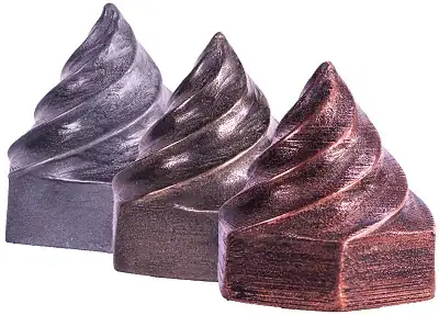

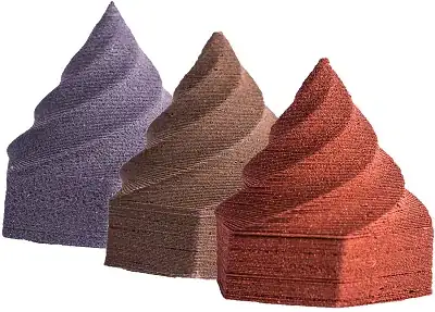

Metal filament
You print with a special filament that contains from mixture of metal and plastic. After the print you heat up the object around 450°C to burn plastic away and melt metal grains together. You need a kiln. DIY kiln is about 150$.
The only filament I know is Filamet from The Virtual Foundry. CopperFill from ColorFabb contains just 30% of metal in oposite to Filamet containing 80%.
- virtual foundry youtube channel
- review: https://www.youtube.com/watch?v=hDIUCzV1vMg
Price
- Copper Filamet™: $ 110.00 / 1kg
- Bronze Filamet™: $ 165.00 / 1kg
- Stainless Steel 316L Filamet™: $ 248.00 / 1kg
Just remember that these filaments are pretty dense which makes 1kg spools quite "shorter" and thus even more expensive!
