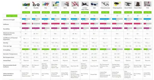

A very nice generic overview is given by Simplify3d:
This figure shows an overview of many of the used materials in 3D printing enter image description here
When looking closely, and without pointing to specific brands (to avoid a commercial posting), your best chances for appropriate filaments for your application is to look at Nylon, Polycarbonate (do not consider Polypropylene; that is very difficult to print) or (not mentioned in the overview as they are more recent filaments) Co-Polyester polymers.

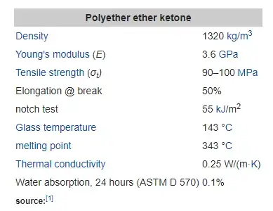

I recommend PEEK if you are able to print around 400 °C.
From Wikipedia - Polyether ether ketone
Wikipedia's property chart
