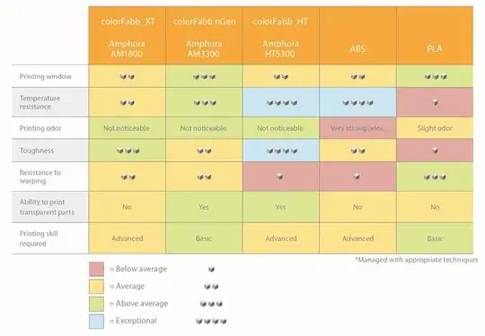

Example of filament comparison Comparison of common and co-polyester filaments
If a heated bed is no option, PETG is you most likely candidate for printing as many filament manufacturing brands say that a heated bed is optional. My personal experience is that PETG very much likes a heated bed, getting it to stick at lower temperatures is more difficult.
