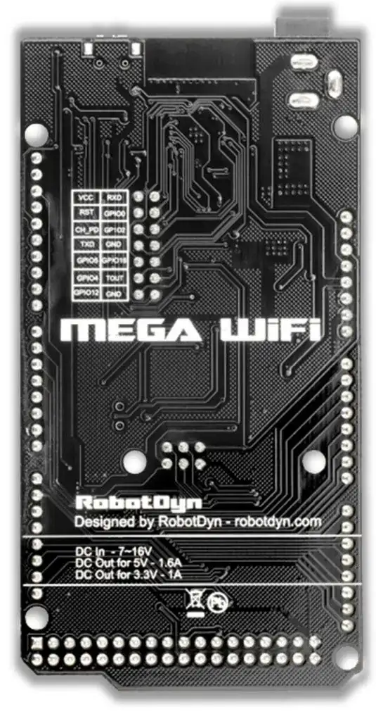

After having looked into them, these boards certainly seem to be rather interesting.

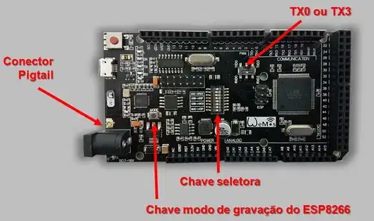

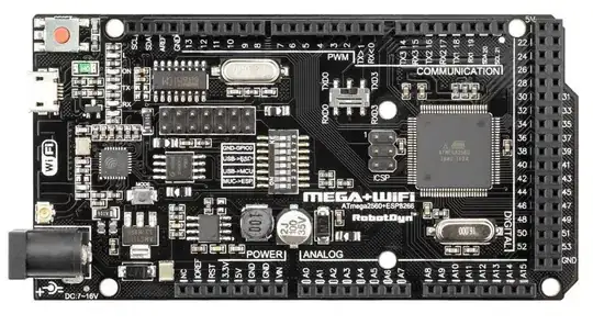

There appear to be two varieties of this board, as I have seen photos with either RobotDyn:
RobotDyn board

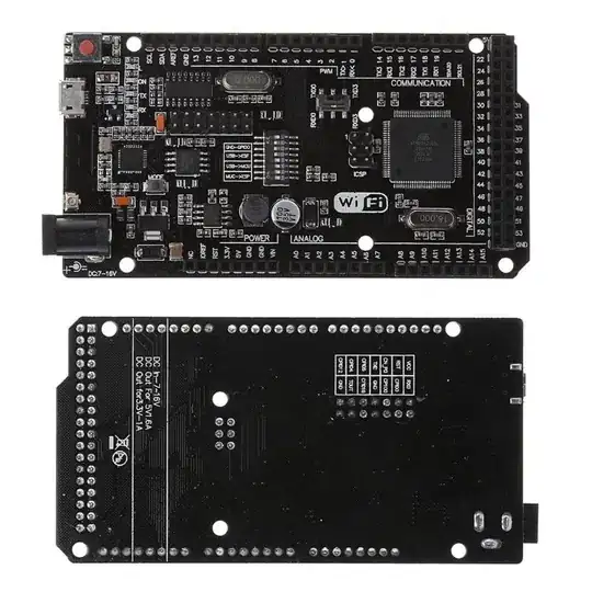

rear (from Instructables)
RobotDyn board (rear)
or WeMos logos on them.
WeMos board
They may, or may not, be the same. There is also this one, with just a generic "WiFi" logo (from the eBay page below):
Generic board

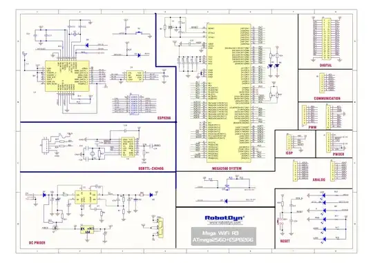

So MB or Mb? Is there an additional flash IC external to the ATmega2560? Looking at the schematic, taken from the Russian RobotDyn page, there doesn't appear to be:
RobotDyn schematic
So this could be nonsense. Logic would dictate that the ATmega has 256 kB and the ESP has 4 MB... But I could be wrong..?

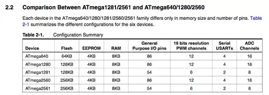

2 From the Atmel ATmega640/V-1280/V -1281/V-2560/V-2561/V datasheet
ATmega256 memory
