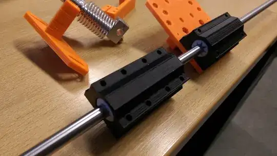

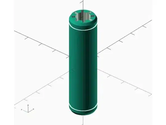

This image shows an example of the application of customized igus® bearing that is as long as the housing part it is going to fit in: customized igus® bearing

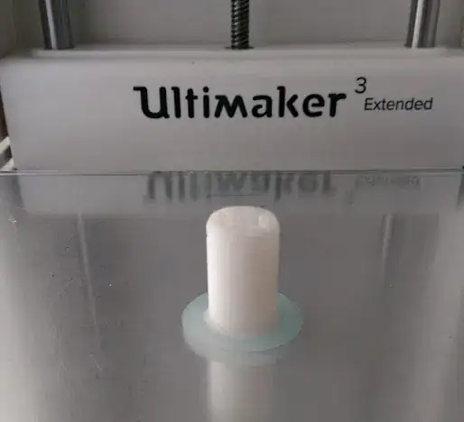

Ultimaker 3 Extended with printed POM bearing:
First thing I learned is to use quite large brim's (the image above shows a rather small one for this short bearing, for the longer bearings the brim size was more than doubled, e.g. 20 mm), brims enlarge the surface area so that there is more material that grabs hold of the heated bed. Also ensure to get it to stick long enough is heating the bed to 80 °C after smearing ABS juice (ABS dissolved in acetone) and spraying a PVA based spray over the dried ABS juice layer (3DLAC has been used, but other hairsprays or even gluesticks may work as well, as long as there is PVA in it). The temperature of 80 °C is chosen as this is the temperature where my PVA spray has the most tack/sticky-ness.

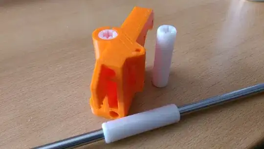

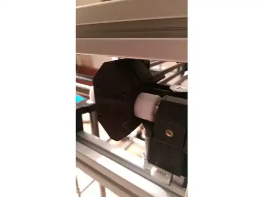

This image shows an example of using the printed customized igus® POM bearing that is as long as the mount height:
Prusa clone X-axis mount with inserted custom bearing

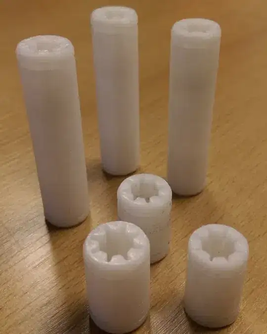

Collection of POM printed bearings:

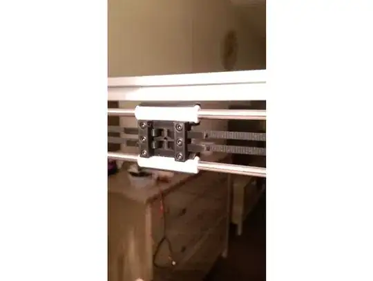

Another application of POM bearings:
Bowden E3D mount
CoreXY hot end carriage
Hypercube Evolution hot end carriageHypercube Evolution X-Y mount bearing
