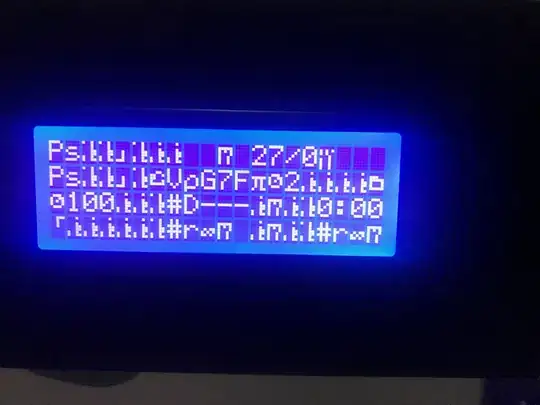

Everything works fine but, sometimes, right after finishing a printing (while doing the "home all"), the LCD shows some weird data, like this:
LCD weird data
The same happens when push the "confirm", after the mesh bed leveling.
I'd like to know why it happens. Is it a Marlin bug?

This is a known problem of the Anet A8 display, it is caused by electrical interference. Pressing the middle button will refresh the display.
This is prone to happen when doing long prints.
There are some reported successes of people inserting ferrite beads or toroidal rings.
No, this is not a firmware issue, this is a hardware issue.
  • My first though was about the Marlin because with the original firmware it never happened. So, I'm guessing now it was pure luck. Pushing the middle button indeed refreshes the display, except for the first character, that remains messy. – elias Jul 05 '18 at 00:09
  • Yes, this happens with unprotected shields and when we use a kind of polyester cloth and we are so close to the drivers. So be aware to avoid to use this kind of cloth, use cotton clothes. – Fernando Baltazar Jul 05 '18 at 03:15
  • @Elias Maybe pulling the flat cable from the sockets and re-inserting the plugs helps. Also keep the flat ribbon cable away from the 12V wires. – 0scar Jul 05 '18 at 06:14
  • Worked for me! Easy fix, just used on old ferrite ring and looped the display wire through it! – Felix Aug 27 '18 at 14:39
I have solved completely, I covered the flat cable, with copper tape, this shield should be connected to the 0V of the power supply. All disorders will disappear.

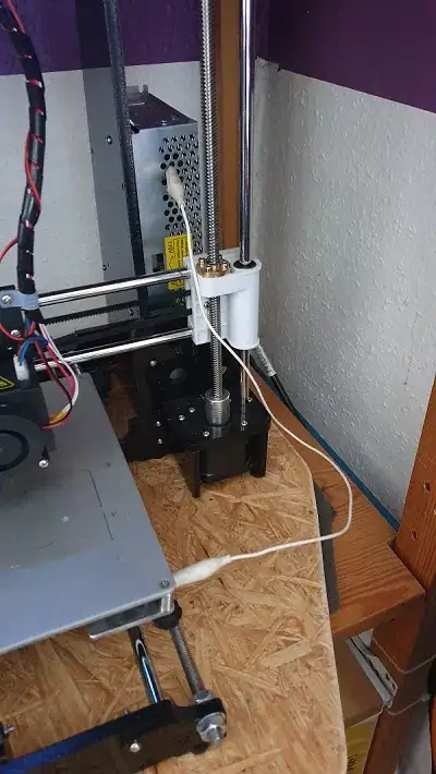

I had this issue for a long time and finally I tried a super-simple hack. Attach a testlead from bed to PSU (which is grounded). Problem solved!
In other words: The Marlin firmware may be more "sensitive" than the original stock firmware, but it is not really a firmware issue.
