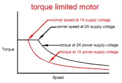

In terms of actual motor behavior, the inductance and back-EMF introduce significant limits because they decrease motor torque at higher RPMs. This produces a torque/RPM curve that drops off at higher speeds:
enter image description here http://www.geckodrive.com/support/step-motor-basics.html
Note in the picture that there is a flat "constant current" region on the left side at low speeds. This is the range where the chopping driver is limiting coil current. On the right side of the curve, current is not able to reach the target before it must be switched back off for the next step. That reduces field strength and thus torque.
There are two separate effects to consider here:
  • Motor coils are inductors, which means there is a first-order lag between applied voltage and coil current. A standard bipolar stepper motor with a microstepping driver must raise the coil current from zero to max or from max to zero every full step (eg every sixteen 1/16th microsteps). At high step rates, there is not enough time to fully charge the coil to its max current before the next step requires dropping the current back down. Without developing full coil current on each step, torque is lost.
  • Every motor is also a generator, and spinning the rotor generates back-EMF voltage within the motor coils. That voltage waveform gets overlaid on top of the drive voltage waveform with a phase shift dependent on the rotor position relative to the coil energization position. In simple terms, this voltage attempts to brake the motor: it always does whatever will slow the motor down. This means it opposes the applied drive voltage when the motor is applying forward torque, or assists the applied drive voltage when the motor is applying brake torque.
For a practical discussion of speed limits, we can simplify the situation by assuming back-EMF voltage opposes the drive voltage applied to the coils. This means there is less effective voltage raising/lowering coil current, and it takes longer for the current to change, and less coil current is developed than would be the case without back-emf. This further depresses the torque/RPM curve of the motor. And when the back-EMF voltage is around the same magnitude as the drive voltage, significant motor instability can result because of complex feedback effects between rotor position and effective coil voltage.

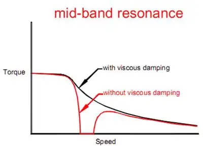

Another important effect for steppers is mid-band resonance. This is not a normal mechanical resonance, but actually an electromechanical resonance effect. It's quite complicated, but the short explanation is that a stepper has an intrinsic 90-degree phase shift between position and torque, and when speeds rise to a point where coil inductance introduces an additional 90-degree phase shift between coil current and applied voltage, the electromechanical system has a highly-unstable 180-degree phase lag and thus creates a negative feedback loop. This can rapidly drop motor torque until the motor loses synchronicity with the driver's applied voltage and stalls.
Mid-band resonance only occurs when coil current is limited by inductance. It cannot occur in the constant-current drive range because there is not enough phase lag between applied voltage and coil current.
Unfortunately, measured torque curves available from manufacturers almost never show resonance zones, because the curves are produced by loading motors with friction-brakes that damp any kind of resonance effect from building. Whereas a 3D printer drivetrain load is almost entirely inertial (accelerating a mass) which is much more prone to resonance.
High-end drivers can automatically detect and damp mid-band resonance, but typical low-cost 3D printer drivers do not have this capability.
It is generally prudent to avoid entering an RPM range where mid-band resonance may occur. This is easily accomplished by sticking to the left side of the torque curve, in the constant-current operating region. This ensures high torque and good stability.

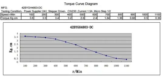

For a concrete example, consider the popular Kysan 1124090 stepper with a 24v power supply.
enter image description here https://ultimachine.com/content/kysan-1124090-nema-17-stepper-motor
To maintain high torque and avoid mid-band resonance, we would want to keep the RPM to about 400 or less. For the same 32mm-per-rev pulley mentioned above, that would limit speeds to around 200-240 mm/s. Higher speeds are possible, but may encounter reliability issues.
This speed, of course, assumes a 24v PSU is used, to match the measured torque curve: a 12v PSU would have a significantly lower top speed before inductance starts to limit coil current, around half as fast. Higher supply voltage greatly increases the top effective speed for the motor.

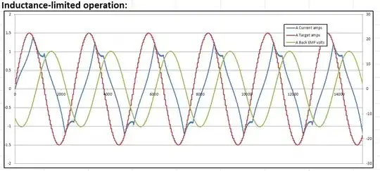

Again, you can easily simulate this effect (using https://github.com/rcarlyle/StepperSim). This simulator output chart shows how inductance and back-EMF are keeping coil current from reaching the target:
For practical drivetrain design, a motor/driver simulator is really the best tool in the toolbox for finding the point where performance will start to degrade due to inability to hit current targets. It's simply too complex to apply simple equations or rules of thumb with any accuracy. These electrical effects and the firmware step generation limits are likely to be the two main restrictions on motor speed for most printers.
