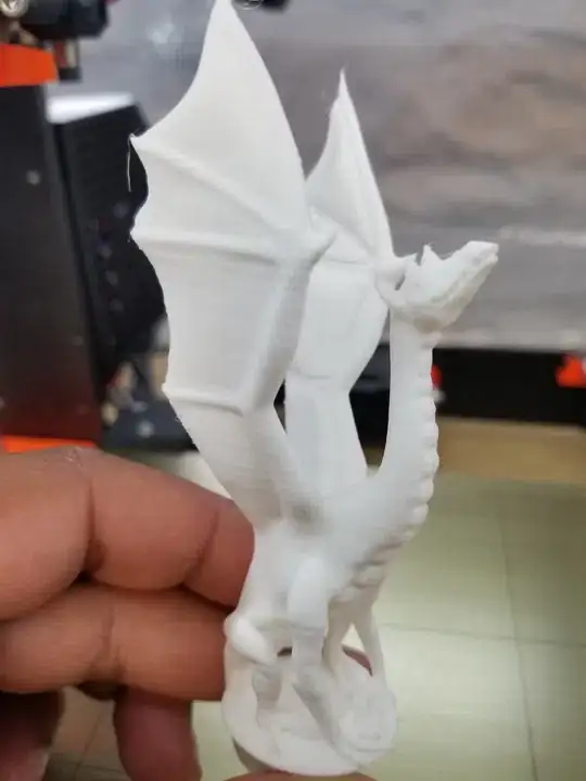

I picked up some samples from PP, specifically their glitter filament and a couple of the premium HTPLA filaments. I printed one small piece with the glitter filament the first night I got the package, but I haven't been able to get any of the filaments to print since.

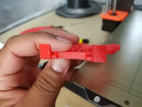

The problem seems to be that the filaments won't extrude from the nozzle and this problem applies to all of the samples I got. If I unload the HTPLA and print with any of the other filaments I have been printing with (various inland filaments) they all print out fine.
I thought maybe I had a clogged nozzle so I did a couple of cold pulls with a different filament. The pulls came out clean each time. I tried loading the HTPLA back in and while the filament extrudes fine during the MK3's loading process it still doesn't extrude when trying to run an actual print.

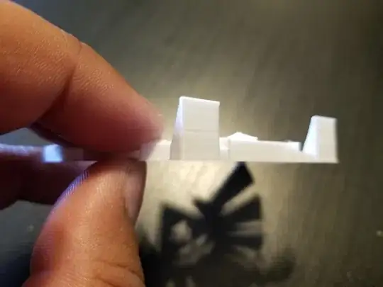

I tried switching back to a known good filament and found that I couldn't get anything to extrude anymore. After researching a bit online I suspected that there may be an issue with a clogged nozzle, so I did a couple of cold pulls and then tried one of my known good filaments again. This time I was able to extrude and print out a full test without issue.
After that I switched to one of the HTPLAs and it started printing. I thought all was good, but during the course of the test print the nozzle clogged again and stoped extruding.

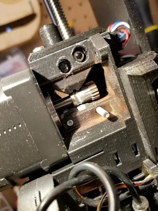

With the nozzle ruled out, I started looking elsewhere on the printer. After watching a video from the 3D Printing Nerd on extrusion issues he was having on his MK3 I decided to check the extruder pulleys. When I tried to open my extruder idler pulley door I noticed I couldn't actually get it open; it seemed to be stuck on the bottom. I tried to free the bottom of the door, but couldn't without forcing it past my comfort level. Instead, I unscrewed the top of the pulley door to remove it.
From here I noticed two things, I didn't get the pulley teeth as clean as I though I had before and the idler pulley's mounting rod was extended just a bit (which is what was causing it to stick at the bottom). I adjusted the rod and put the door back on. It was printing better but still had extrusion issues.
I then watched the pulley during the filament loading and notices that while the extruder stepper motor was turning smooth, the idler pulley was stuttering a bit while turning. I imagine those little stops and starts were what was causing the extrusion issue.
I opened the idler door back up and worked the idler pulley a bit with my finger. It started to spin free (maybe there was gunk in it? maybe it was rubbing a bit against the mount? ¯\_(ツ)_/¯), so I closed the door and screwed it back in tight.
