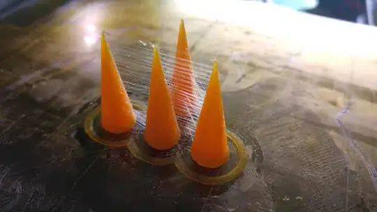

Retraction is the reversal of the direction of the filament and is generally used when moving from one non-contiguous point of the print to another, in order to prevent stringing and oozing of the filament. If retraction is not employed then the filament still coming out of the nozzle, after the last point was printed (and paused), will stretch, thus creating a fine string, as the print head is moved to the next position where printing is to recommence.
Stringing

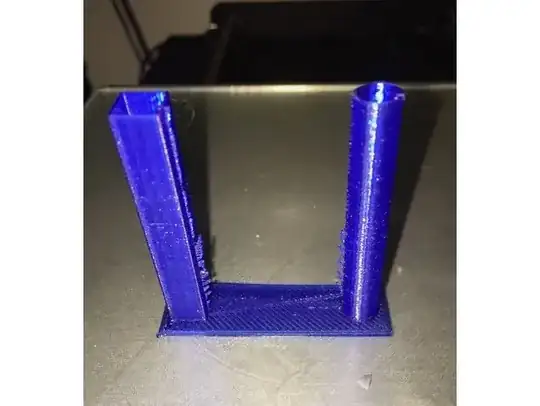

The calibration object prints two towers about 30 mm apart. The head must move between each of the towers at each layer. If your printer is not set correctly then you will see many fine filaments (or strings) between the two towers. You can eliminate these filaments by eliminating ooze.
