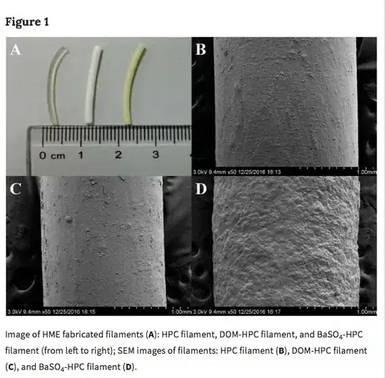

There is also this, which refers to the Melocchi paper above, Fused Deposition Modeling (FDM) 3D Printed Tablets for Intragastric Floating Delivery of Domperidone:
Domperidone (DOM)... DOM was successfully loaded into hydroxypropyl cellulose (HPC) filaments using hot melt extrusion (HME).
Several novel gastroretentive delivery systems have been explored to overcome the shortcomings above, including polymer bioadhesive systems, swelling and expanding systems, high-density systems and floating systems3
An image of the filament is shown in figure 1:
Image of HME fabricated filaments
However, as a commercially available filament, you might be out of luck, or at least hard pushed to find one.
