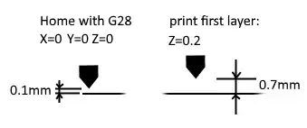

Here is is the part my Question starts: I noticed that the first layer is actually not at the same Z=0 if i use G28 to home and the Z0 it shows when i print a part. For example: Set G28 Level bed with 0.1mm thickness gauge. Then start printing with layer height 0.1mm and initial layer height setting 0.2mm
The result should be 0.1+0.1+0.2 =0.4 real layer height (if i also count the 0.1 layer heigth(not sure if this is correct)) the printer shows here a Z of 0.2 But if i meassure it, it is around 0.7mm thats way to much.

  • What is unclear (i.e. to me) is whether you did change the z endstop height after the nozzle swap. If the nozzle is shorter, the endstop should change (be lowered) as the gap would be too large; so move it down. Setting a software offset will not work as it cannot get passed the zero level of the endstop (unless you enabled that in the firmware, but should not do if it evolves a mechanical switch). Please note that the initial layer is 0.3 not 0.4, the normal layer height should be omitted. – 0scar May 21 '18 at 08:25
  • No i didn't change the endstop. Instead i moved the bed up to close the gap. If i use the G28 command it moves to Z=0. Bed is leveled in all corners and also in the middle and everywhere is the gap between new and old nozzle 0.1mm. If i start Print the gap now is drasticly bigger (0.7 mm). Adding all numbers Z shows 0.2 and the 0.1 when leveling should make 0.3 mm gap. But instead it is now 0.4mm higher. If i home it again with G28 and i measure the gap it is again the 0.1mm. – mithras May 21 '18 at 10:27

    I checked all wheels. No wobble. If i home the level is ok repeatadly. – mithras May 21 '18 at 11:18
  • in that case could you post first 30 lines from g-code generated file? – profesor79 May 21 '18 at 11:20
  • Had time to do some more testing. I think you were right, the leveling is not the same if i move the Z-Axis up a little bit and then home again. Thats where the gap was coming from. Although there is no noticable wobble in any of the carriages. Thanks for the help. – mithras May 24 '18 at 10:34
