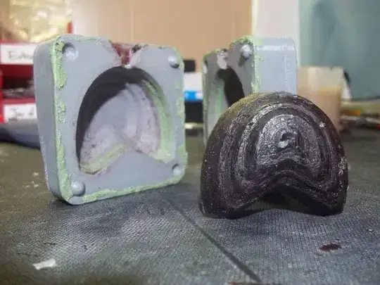

While trying to find a soloution to this problem I came across this forum post, which led me to "Parametric two-part mold generator for OpenSCAD" on Thingiverse.
A set of parametric OpenSCAD scripts that generate ready-to-print two-part molds from arbitrary STL models.
These scripts can be used to generate either square (with or without rounded corners) or circular two-part molds and are fully parameterized to make it easy to adapt for your application.
Here's an example from Thingiverse. A parametric two-part mold, and casted object
