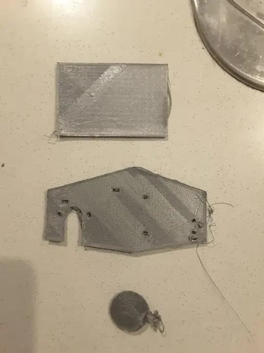

I have excitedly decided to get my feet wet in the 3D printing world, and being that budget is fairly small got myself an ANet A8 3D printer. I have it all assembled and am able to 'print' however I don't really have any luck getting a successful print to actually occur.
At the moment I am printing with PLA (start easy(er) is my logic) and had a few issues with getting the print to adhere to the print bed so found a plastic-like print surface that seems to adhere fairly well but I am still having issues :(.
When the first layers are being deposited onto the bed (extruded at 215, to a bed temperature of 60) they appear to adhere fairly well to the surface, and the layers start to be built up. However, after a random period of time, the layers lost adhesion to the print bed and start to move around the bed which stuffs up all the prints.
in terms of the extruder, the range for the PLA is 190 - 215. I tried lower tempertures but it did not really work in terms of properly melting the filiment unless it was around the 215 range.

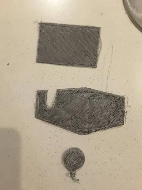

To give you an example of how the prints come out, i have attached two images (front and back) of a set of prints. I stopped these printing as they lost grip on the bed.
Bottom Layer (on the bed) Bottom Layer (contacting bed)
Top Layer Top Layer
Thanks heaps for helping a newbie out. I had tried changing speeds (faster and slower), changing temperatures and so on but i have no real idea what i am doing and was hoping someone far more knowledgable than me could give me some idea on where i may be going wrong and how to fix the issue.

Your nozzle is way too far from the bed for the first layer. You should adjust the bed leveling screws to bring the nozzle closer to the bed, to the point where a piece of paper just barely fits between the nozzle and the bed. You should closely watch the first layer as it is being put down, the plastic should get squished slightly and there should be no gaps between adjacent lines.
