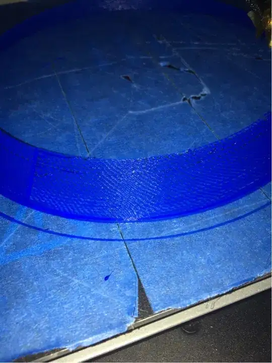

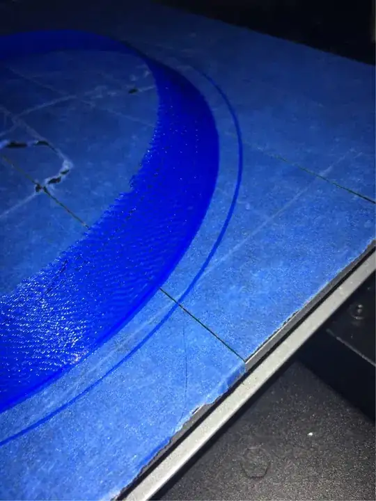

It's my first time printing in vase mode, and I noticed my printer underextruding badly. The settings have not been changed from default vase mode settings in slicer, and earlier I was printing non-vase mode and the prints came out fine. Layer height is 0.2 mm and perimeter width is 0.3 mm.
Under extrusion #1
Under extrusion #2
  • Did you check for the most obvious reasons like friction on filament unrolling, clogging, layer height, etc. – 0scar Mar 26 '18 at 05:10
  • @0scar Yes, I stopped the print and used manual control to extrude filament. It came out completely straight and normal looking. Layer height is set to .2. – patrick jackson Mar 26 '18 at 05:12

You are printing walls of 0.3 mm with a 0.4 mm nozzle (25% contraction). This might fall in the category of insufficient volume flow. The wall width is less than the nozzle diameter, so it needs to contract. Either way, the volume is too less and may be dragged along until it is flattened. You should increase the wall width, maybe even a little more than 0.4 mm (although that might not be necessary, see edit below).

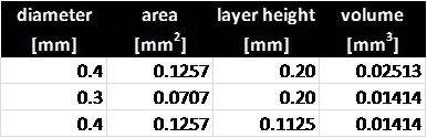

To support this, the next table shows the volume calculation for the filament (based on extruded cilinder shape), the first row is the volume you need to fill the 0.2 mm layer height (0.025 cubic mm), the second is what you extrude with a 0.3 mm width for a 0.2 mm layer (0.014 cubic mm). From this latter value you can calculate the layer height for a 0.4 mm diameter nozzle to be about 0.11 mm, clearly not filling the gap.

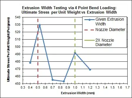

Edit: To further support this, please read this test.
The extrusion width versus strength show the optimum strength when the nozzle extrusion width equals the nozzle size.
  • I'm almost 100% positive the problem comes from somewhere in slicer. Before the vase mode print, my extruder worked perfectly and I was able flawlessly print some models. During the vase mode print I even stopped it and used manual controls to manually push material through the hot end, which worked perfectly. – patrick jackson Mar 26 '18 at 14:24
  • What is the size of the nozzle? E.g. printing 0.3 with a 0.4 nozzle is not optimal. – 0scar Mar 26 '18 at 15:02
  • Nozzle is .4mm diameter. – patrick jackson Mar 28 '18 at 17:33
  • @patrickjackson I have updated the answer for you, I strongly suspect that your volume flow is not enough (so indeed a slicer setting as you suspected) – 0scar Jun 04 '18 at 07:02
