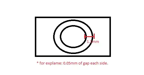

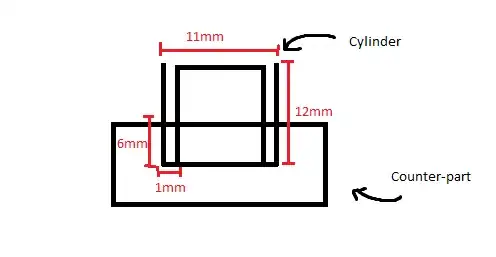

What I have is like a hollow cylinder with a diameter of 11mm, and a thickness of 1mm. This goes inside a counter part, that is carve with the cylinder shape, but with a little extra gap so it can rotate like an axis. Maybe this picture explains better:
And this should be the front view of the counter part:
So, I need to know if it's possible to print that cylinder hard enough to work as an axis. And what should be the gap size between the cylinder and the counter part's hole to rotate properly? If it's is like 0.05mm, can I print that level of detail with a 3D printer too?

(6mm is the depth of the hole)

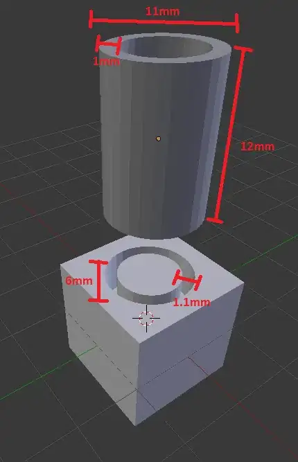

  • By material and hardware I meant this, what kind of technique should I use, you answered what I wanted. SLA/DLP results are hard enough for 1mm of thickness? The piece must be rigid to work as an axis. I don't worry about breaking, but it cannot be flexible. I updated the original post with a 3D picture, maybe it can orient you better. – Julián Pera Mar 22 '18 at 03:34
  • The updated image is excellent. SLA material, once cured, is quite hard. According to a comprehensive article: https://formlabs.com/blog/ultimate-guide-to-stereolithography-sla-3d-printing/ you may see Shore hardness above 70 in the parts. Strength is subjective, however. SLA is going to be no stronger than any plastic with 1 mm wall. SLA will create well at that resolution. – fred_dot_u Mar 22 '18 at 09:56
