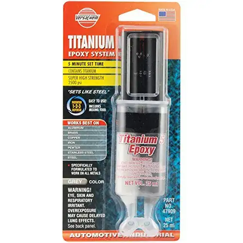

I've been a fan of epoxies for unusual adhesion problems. I found on Amazon a product with titanium in the name, but there's a caution regarding polypropylene plastics.
titanium epoxy
PLA is not of that family of plastic, which gives it a good chance of success. Epoxy is typically more viscous than cyanoacrylates, giving you a bit more control of the application, but also creating the need for care with "ooze-out."

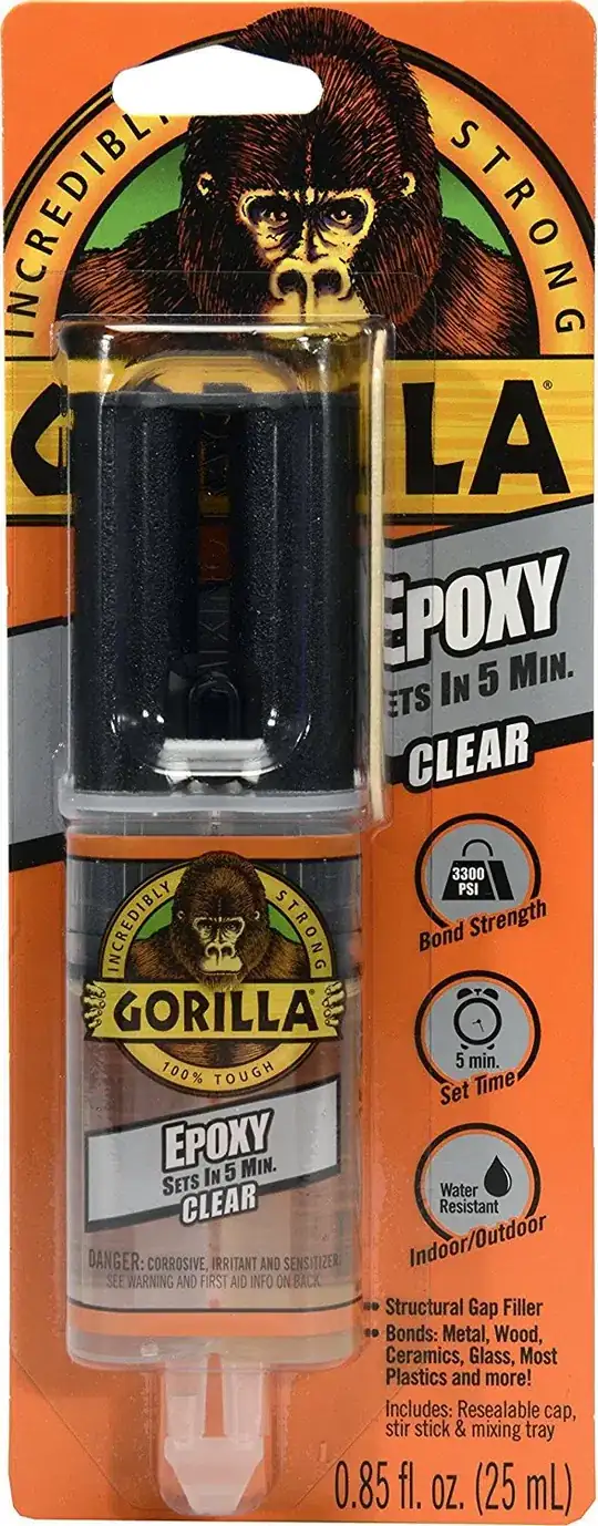

The big glue company, Gorilla, also makes an epoxy that includes plastic and metal in the adhesion listing.
gorilla epoxy
As PLA is somewhat sensitive to heat, one would consider that fast-cure epoxies generate more heat than slow-cure epoxy, but the amounts you'll be using are not likely to create enough for concern.
    "Titanium epoxy" sounds like a marketing term that doesn't actually have anything to do with titanium. – Tom van der Zanden Feb 07 '18 at 13:07
  • Marketing does go overboard in many circumstances. I suppose that since the packaging reads "contains titanium" they can get away with it. Of course, does 1 gram of titanium allow for such claims? Even what might be considered titanium debris would qualify and validate the packaging. Who can say if it adds strength to the product? – fred_dot_u Feb 07 '18 at 17:05
