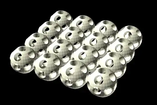

small test
For reference, the code at the bottom of this answer (which generates the image above) behaved like this:
  • With render(): 15s for the preview, 1m29s more for the proper rendering (TOTAL: 1m44s).
  • Without render(): 0s for the preview, 1m45s more for the proper rendering (TOTAL: 1m45s).
I don't know if the fact that the totals resemble each other is a coincidence peculiar to my model or a general rule of thumb (the render() function effectively creating part of the final rendering during preview), but you are free to play with the code and if you find out a pattern, please leave a comment.
In the following code, you may need to increase the grid size to 20x20 if you want to see the difference in responsiveness between vanilla code and render() function.
Also remember to close and reopen OpenSCAD between tests, in order to flush the cache.
