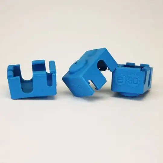

  • Make sure that your hot end is well insulated. If available for your printer, silicone sleeves are the best:
silicone sleeves

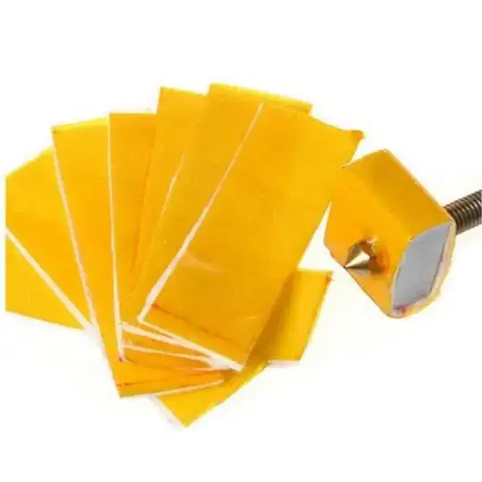

otherwise the most common, universal and low-cost solution are cotton pads:

    I am up-voting this because it turns out that it was because my extruder was not insulated. I purchased some cotton based insulation and wrapped it around just like the picture above and my temperature became stable again. – Razor Feb 17 '20 at 09:39
    My hotend was touching extured motor metal holder. After giving distance between them it started to reach correct temperature. I also supported the situation with silicone cap and cotton insulator. – Sami Onur Zaim Apr 10 '21 at 11:44
